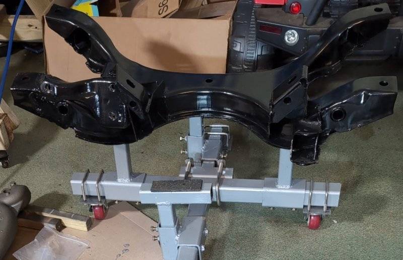

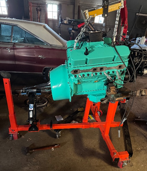

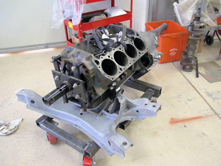

K member, engine and tranny stand
I will post up some pics and measurements
this weekend when i’m back in the shop

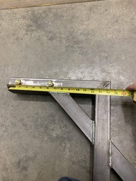

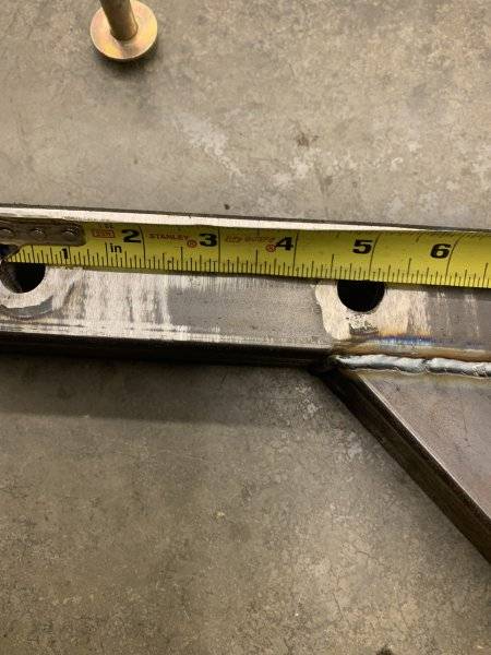

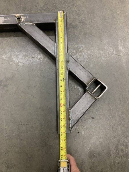

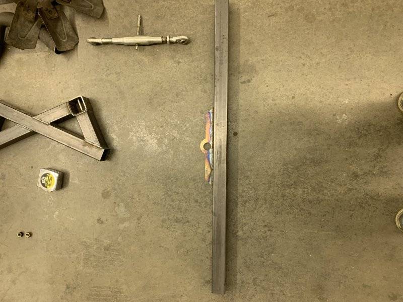

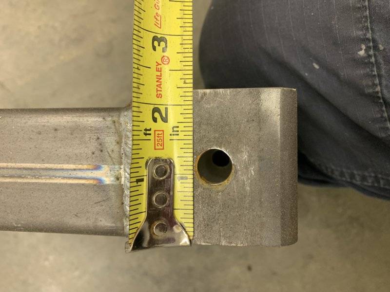

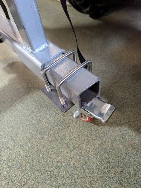

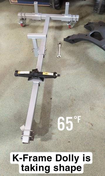

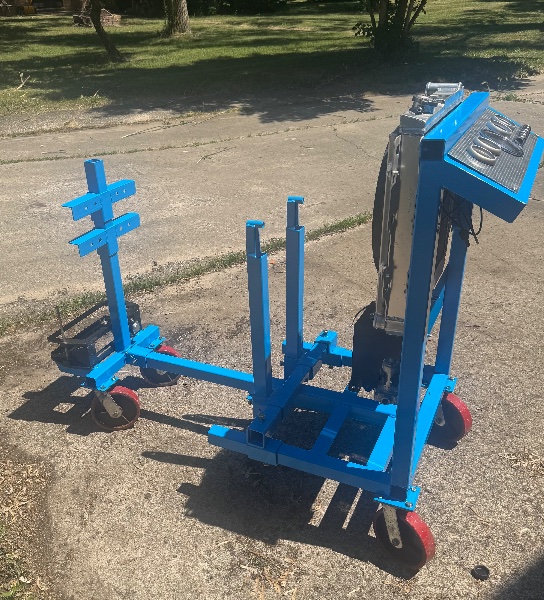

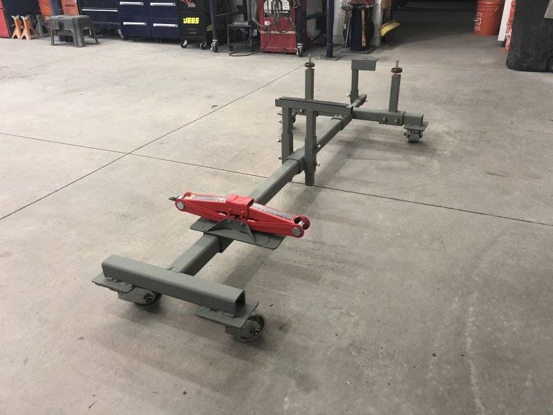

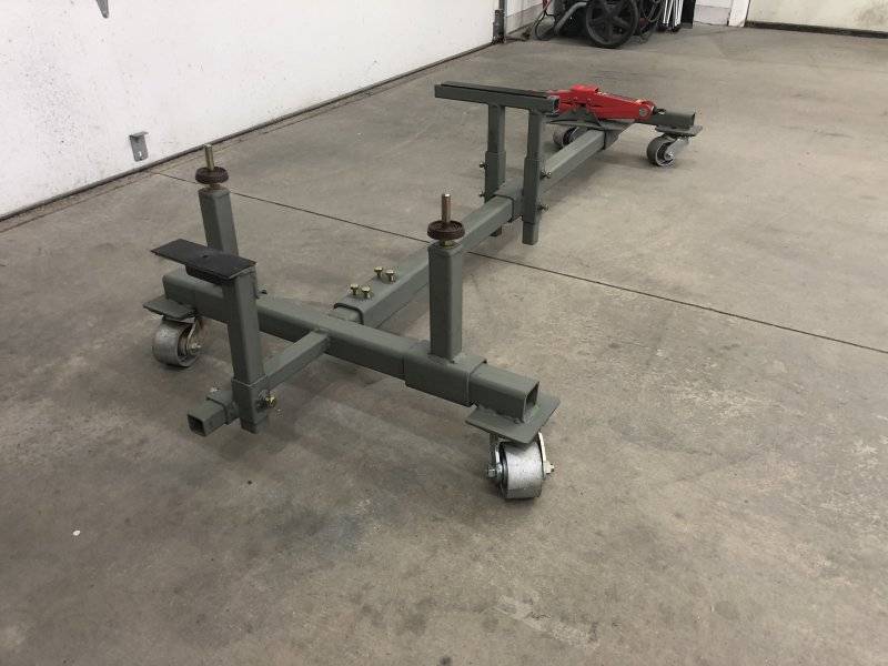

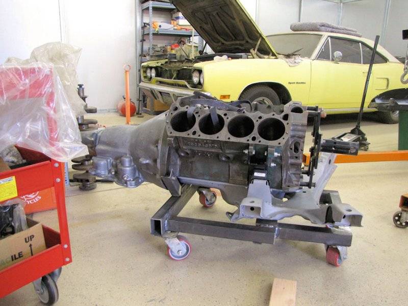

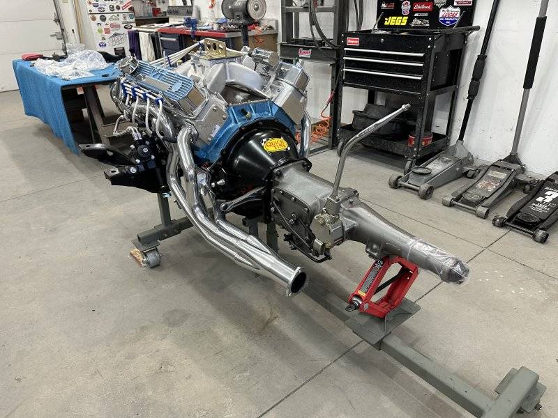

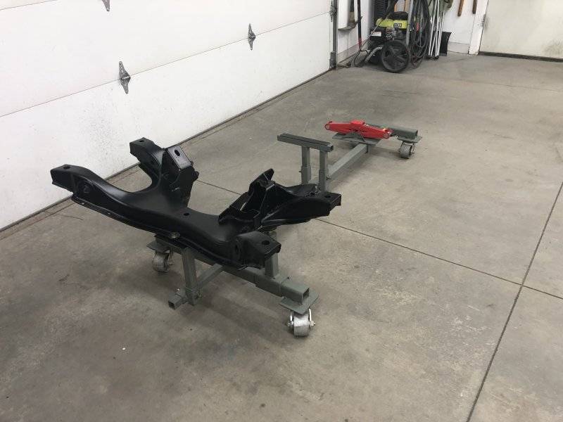

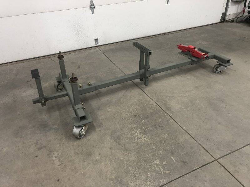

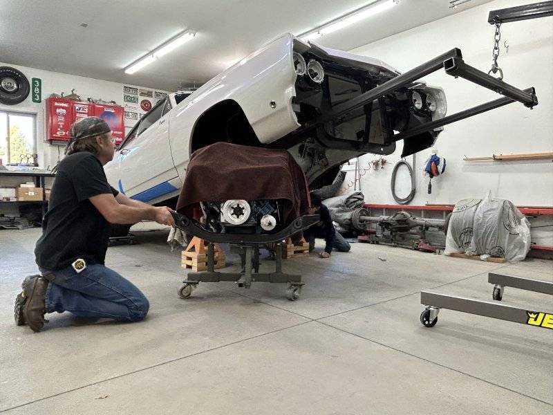

Here’s some pictures with measurements for the lifting attachment. The two pieces of 2 1/2” square tubing once drilled will need a 1/2” nut welded to them for securing the 1/2” bolt that holds the cross bar in place.
The rest of the tubing is 2” square thin wall also the 2 mounting holes for each side will need reinforcing tubing welded in place.
Thanks, that gives me the info I need. Much appreciated!
