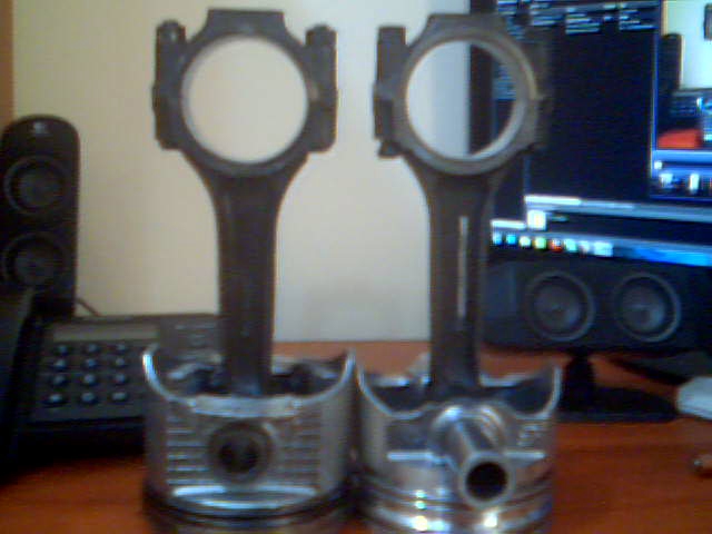

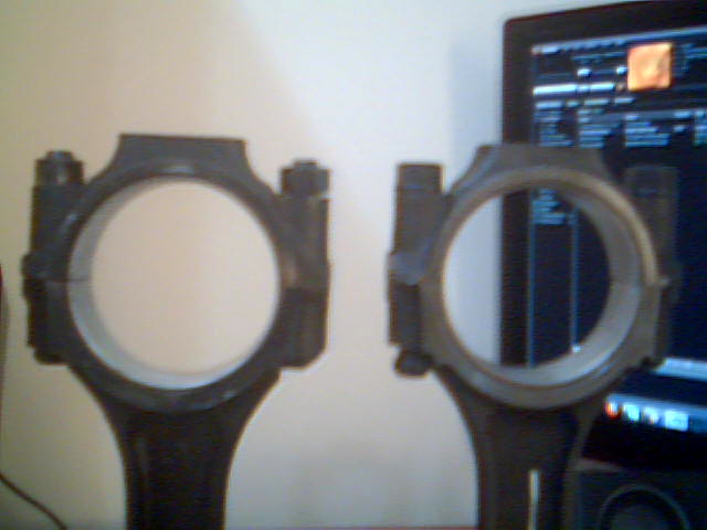

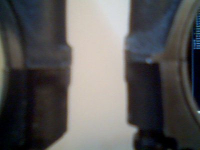

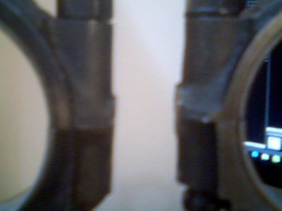

i had the piston and rod checked out by another mech he put the pins on both the old and new piston an set them both flat on the ground.....there is a tiny difference in height...could this be cause of the .100 down in the bore thing??and there is also a slight difference when he measured from the pin hole to the top on both pistons(the new kbs pop up a bit:S:S anywas having the crank mechanied getting it tommrow so were going to set in the new pistons and see if it goes out the bore????
and he told me tht if the pistons were going a tiny bit off the bore deck we could mil the piston a bit ?/can i do that ?
here are some pics .....ill get some good ones tonight.......

any chance if it wold fit?did anyone else have this problem?
The compression height of the KB 237 piston is 2.067. The compression height of the stock piston is around 1.967 which is an estimate. It's probably worse. The 6 pack piston is 2.062 for example. Depending if the block deck has ever been milled, the KB's should be around .010 to .015" below deck. Factory deck height of the block can and do vary some because of production machining tolerance. You should be fine with those. What heads do you plan on using?
The above picture is not a correct method to check rod length.
The KB237's will work but you will have higher compression as I said in post #2 of this thread. I am running these exact pistons in a 77 440 with closed chamber heads and steel shim gaskets. I just need better than 91 R+M/2 gas is all. If you have open chamber heads you can drop about .4-.5 points of compression. Eddy aluminum about the same.
