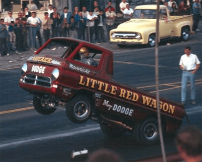

Would know big *** wheel stands, can be done even by 12 second cars,
it's not all that impressive, in fact many time it's slowing the car down,
if it's bar angles & shock settings & front suspension drop
& set up to do it, mainly it's just a lower bar angle & traction deal...
It doesn't take 1000hp or 600+ ci to do big *** wheelies...
Maybe to keep it up on the bars/on the back tires thru a couple gears, it would !!
But not just "jerking them up" on the starting line out of the staging beams !!
