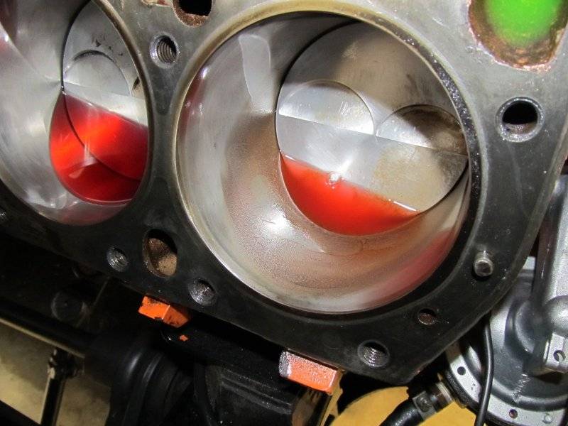

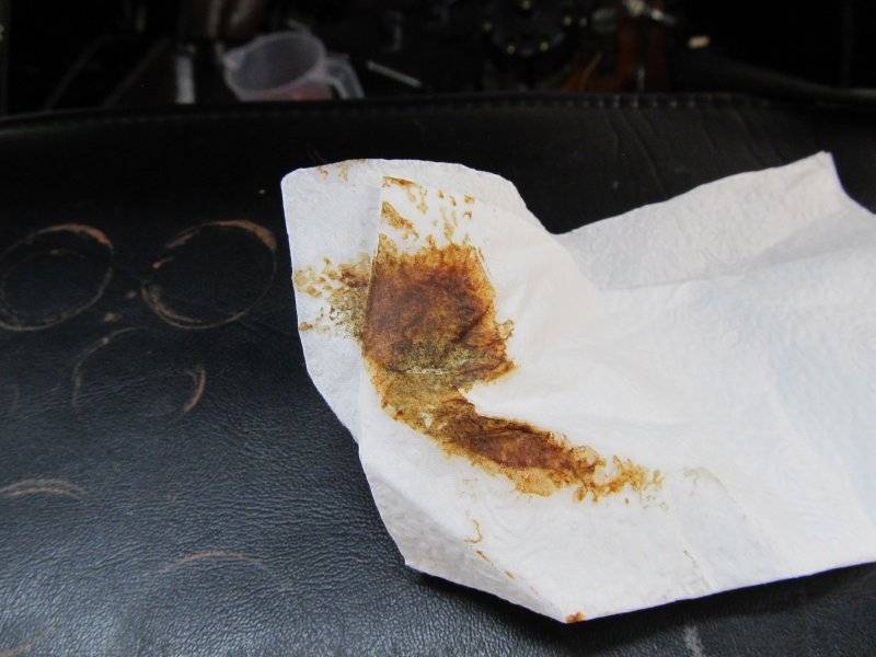

It is definitely not rust. The kroil is pulling something out of the cylinder walls. Here is a pic of residue and another of what color it is when wiped off. There is no rust in bores at all.

Ok I agree it is likely antifreeze coating reacting with the kroil. Not all cylinders are doing it so that makes sense. Yes I know not draining the block was a brain fart on my part LOL.
Why is nobody thinking that the krill itself is depositing a residue on the cylinder wall, given the red color of kroil? Rust would not be shiny like that.
