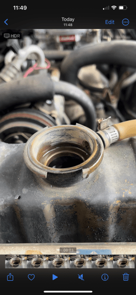

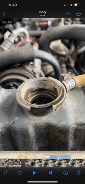

as it’s getting warmer smoke is coming out of the rad, not very visible in the photos
How much run time does your motor get? Does it get run for a good amount of time or mostly stop and go driving? Does it sit for extended periods of time? I’m sure it was posted, does the white smoke have an odor to it? Coolant leaks will give off a sweet odor. Hold the palm of your hand about an inch or two away from the tailpipe for a few seconds then smell it. If it is coolant seepage, you will find routinely lower level of coolant after driving it. When tightening bolts are you using a torque wrench following the engine torque specs? No coolant loss? No coolant leakage? Is the motor overheating at all? Do you know if the motor was seriously overheated before? With the rad cap off and engine hot there will be some vapors coming out. More noticeable on a cool day. As posted, did you inspect the plugs? Wet? Carboned up? Know when the last time the motor was tuned? Condition of the plug wires, distributor, etc.

up until i was having problems with it a couple weeks ago i was driving it every day as is my daily & the journey to work is about 20 miles so it was getting really good use. I don’t think the smoke has an odour but i have a cold at the moment so will check again when i’m feeling a bit better or see if one of my neighbours will check for me. the coolant does seem significantly lower than what i would’ve expected it to be though, has lost about 2L in maybe a months worth of driving whereas normally it doesn’t lose that much. I just tightened them using a spanner. It’s never overheated since i’ve owned it for the past 3 years and definitely hasn’t done recently. It is really cold today so that makes sense, need to check the plugs still but have just moved house and still unpacking / need to find my plug sockets! I replaced the whole ignition system when i imported it almost 3 years ago but haven’t ever had it tuned. will pull the plugs as soon as i can and see what they’re looking like
The source of the white smoke needs to fixed FIRST. With power brakes, fluid from a leaking m/c also produces white smoke.

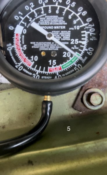

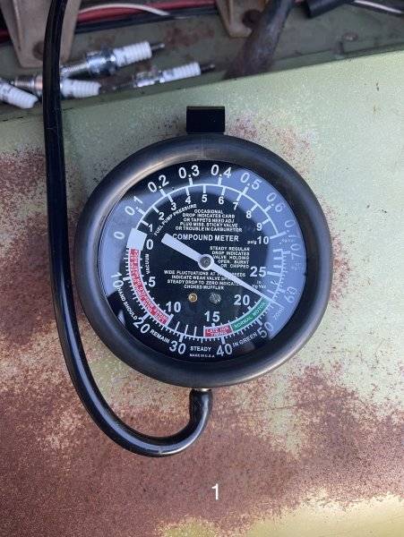

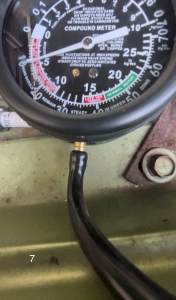

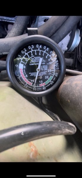

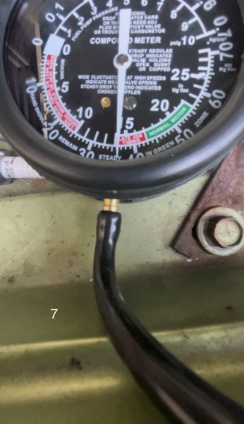

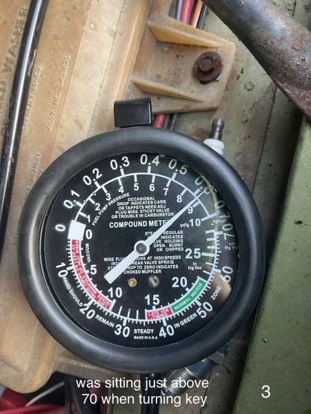

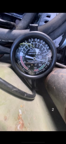

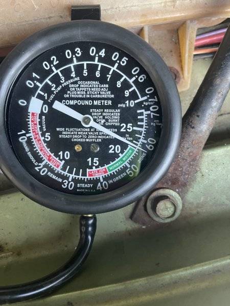

oops that’s my bad, thought i put an update of the compression tests as well. need to redo 6 & 8 as seem to have lost the photos. i also did a test wjtb that Reld liquid and it didn’t change colour so hoping that means the head gasket is okay. The plug wires are fine and have checked the dizzy cap and that looks fine. it runs fine without overheating and doesn’t appear to be leaking, it was leaking before i stopped running it but a head gasket change sorted it. what does MO mean?
Missed it I guess. MO = My Opinion.
Good luck on your project sounds like you are moving ahead.
What do the pictures represent?
I think they represent compression test readings with a vacuum gauge?
I'd like to see how they are attached at the plug hole.
So you had a leak before and fixed it by replacing one head gasket or both head gaskets?
