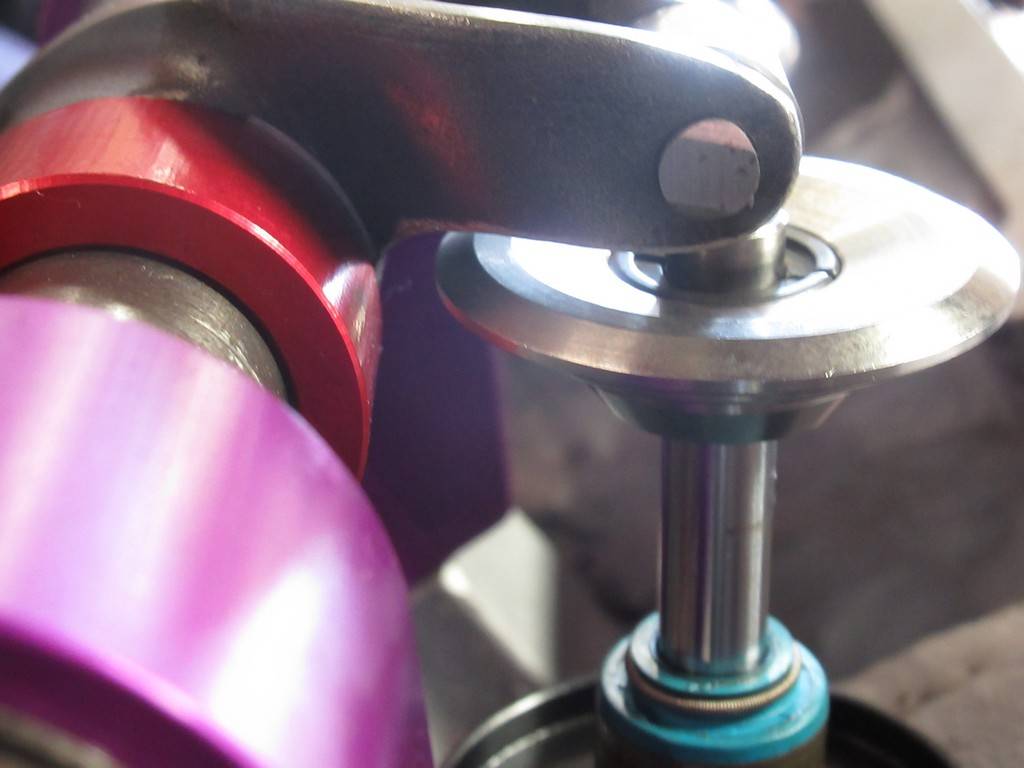

Working on a Gen 2 472 Hemi. Been thinking of using lash caps mainly because I never did before. Anything you could tell me ? Do you just place them on top of the valve stem, and go about adjusting the valves? It has a hydraulic flat tappet cam and roller rockers.Many thanks in advance !
Lash caps are used for non hardened valve tips or to help rocker geometry.

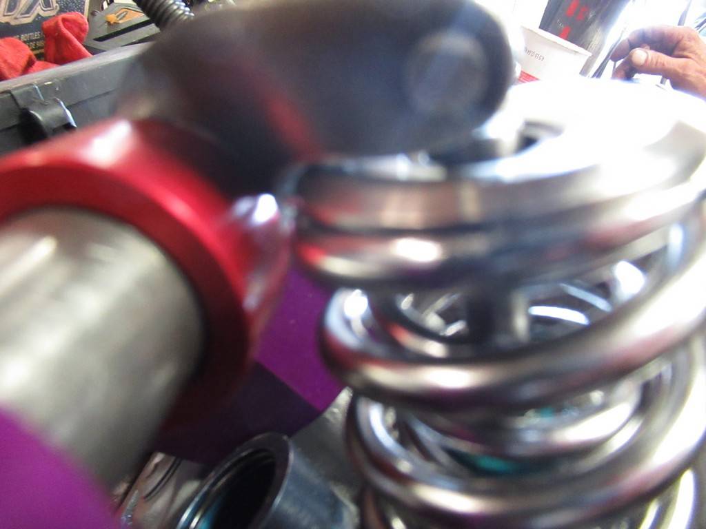

make sure they {lash caps} contact the top of the valve-stems &
they don't contact the keepers/locks, fit snug on the valve tips
with no interference with the rocker body, keepers/locks, retainers etc.
make sure the rockers tips/rollers etc. stays in the center
or close as possible to center of the valve tip
thru-out the camshaft rotation full cycle

The location of the keeper in relation to the height will determine if a standard lash cap can be used.There is also the shorter lash cap that is .150 to .162 tall.If the valve tip does not protrude enough above the keeper,the shorter one is needed.
