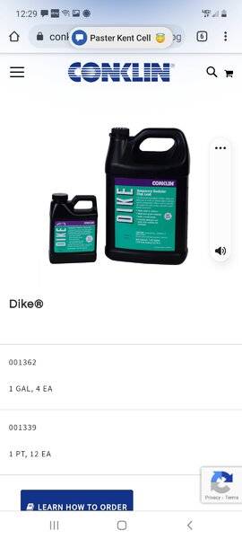

Best stop leak I know of. Dump it in and no worries. Got me a extra year out of my aluminum radiator in my 6.7 cummins. On a tractor that had a cracked head blowing antifreeze out of the exhaust it stopped the leak. It will leak out over time and it's not uncommon to have to put more in.
And a great name.:lol:
