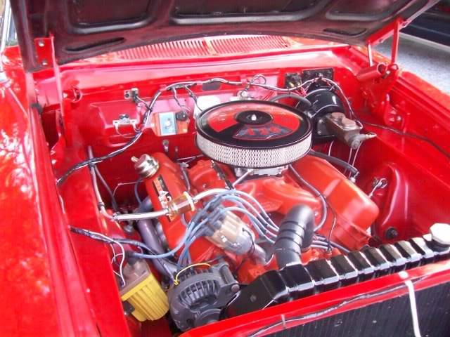

I was told the same also that you have to bang the firewall back some for room with the crossram when you use the 66 and up K-frame as it moves the eng back about 2" I believe. It will help weight transfer but I have my stock K-frame in my 63 and everything fits fine. I use Hedman 1-3/4 headers and a Moroso 8 qt oil pan and they both fit with no mods at all. You can get an idea how my eng sits with the stock K-frame as it would be about 2 " closer to the firewall with the newer K-frame. Ron

Do you have a straight on engine bay pict of the 63? I want to see how the stock v8 K-frame has the engine shifted over, stock. Also; headman elite headers? part number and what oil pan part number?
I've got to buy and oil pan for the 65/440 deal. thanks!

I use a Moroso 8 qt pan but I have to look up the part# as I dont remember it or the headers part#. I will have to get both of them for you. I dont have a good straight eng pic but you can see how much room the drivers side has and the next pic will show you how little room the pass side has. Ron
This shows the pass side as like most all Mopars the eng is off to the pass side some. Ron
