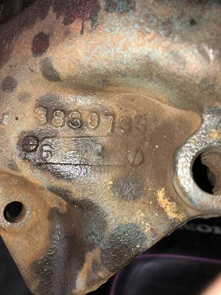

Hey all,
I recently picked up a ‘69 casting 2806178 intake for my ‘78 440 and I’m in the process of putting my C4-TQ thermoquad carb on it. I stumbled into the problem that the carb bolt holes do not line up at all. Is there an aftermarket spacer I can use to fit this carb on the earlier intake? Or do I need a whole new carb? I’d like to keep the carb since I already bought the rebuild kit, but if I have to get another one, which one should I get? Not trying to spend too much on one since I plan on making some performance upgrades to the engine later this year (intake, cam, heads, pistons, etc).
Carb: C4-TQ 9247S
Original intake: 3830733
‘69 intake: 2806178
I used the original base gasket to show how the carb would fit on the original intake and the ‘69 intake.
Any help is appreciated. Thank you!
Chris

Your Thermoquad carb will not work on that intake without a adapter. You might need one for a GM Quadrajet carb as long as the bolt pattern is the same.
The 4 hole (square bore) intake isn’t for TQ carbs.
There are adapter plates available though I’d go to the correct intake manifold. It’ll be much better off that way.
Why not use the later spread bore intake? You can close off any emission ports.
ABSOLUTELY correct.....change the manifold to match the carb you want to use OR use your existing manifold and place a for sale ad for the T-Q rebuild kit and use the proceeds of the sale to buy the rebuild kit for your original Carter AVS carb. IMO, the origional AVS (or the Edelbrock or "Eddy" equilivant )will be easier to tune for your anticipated/fourth coming revisions....... just a thought.....
BOB RENTON
I would get a later intake. They are easy to find and are honestly a better intake with more interior volume. Downfall being the EGR porting which can be blocked easily.
Looks like you have the correct spread bore intake.That's what the photo shows. Use it.
You will have no gain using the 69 manifold.None.The spread bore will flow as good if not better. I am a big fan of Thermoquads. Great carbs.
OR if that's not your spread bore manifold,get the correct carb for the 69 manifold.
Years back I tried a number of times to use adapter plates because of lack of funds. At least 90% of the time it didn't work out well. You'll likely have trouble getting a good seal around the secondaries and hood clearance might be a problem/
Me ? I'd use a spread bore intake with the TQ. block EGR. Case closed.
