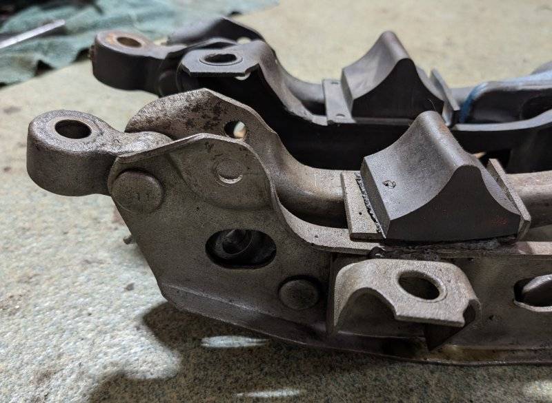

Good morning, I recently bought a front suspension out of a 68 charger to use some of the parts on my 70 Charger (steering knuckles, etc). I noticed the sway bar tab was located more towards the wheel on the 68s - is that normal? Trying to make sure my 70s are correct and then understand what years the others "fit" if I decide to sell them later OR get another project car :) Do they all fit all the 68-70s with some "adjustment" or do the tabs change the model/years/usage?
The bare LCA is out of my 70 charger and the black with blue paint is out of the 68.

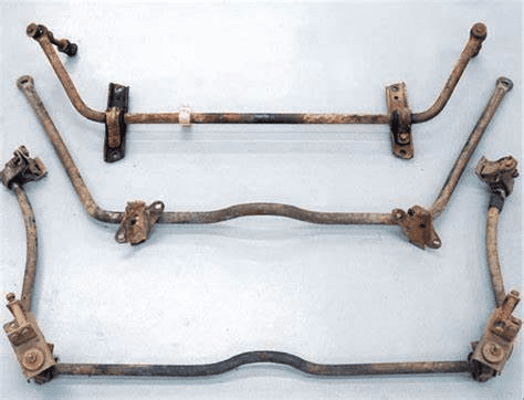

If you view the different year suspensions, you'll notice the "thru-the-k-frame" sway bar and the "outside-the-k-frame" sway bar.
Top is 66-69 B-body
Bottom is 70-72 B-body, All -E-body
They are typically stamped RW
Top is 66-69 B-body
Bottom is 70-72 B-body, A-E-body
autoxcuda, miss typed his reply to you.
Lower control arms are not the same between the A body line of cars, and the B-E body line of cars.
There is an overall length difference between the A body cars, and B & E body cars.
Yes the B & E body LCA's are marked RW.
The A body LCA's are marked VL.
Your top LCA is sway bar mount equipped for 66-69 B bodies.
Your bottom LCA is for 70-72 B & E body cars, if it's stamped with the RW letters.
Hope all this helps you out.
