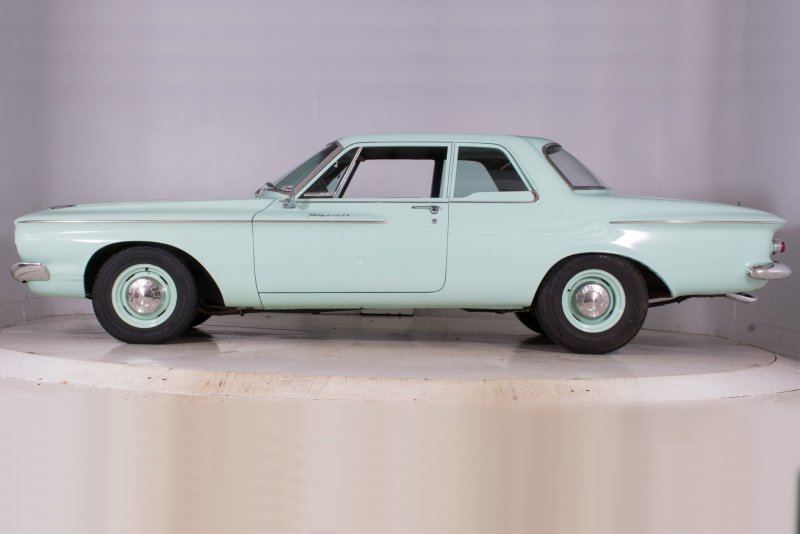

There’s a shop I forgot about I called back when I was building a model T racer I was gonna get a spring shop to drop the car a bit I totally forgot about that and didn’t think of just having them modified. Next question, anyone have a picture of what it looks like? lol
6 leaf 2- and 1/2-inch recurve on my runner General Spring company. Springs do get tired and metal fatigue after years. Very happy with my new springs and don't need air shocks. Thought it might ride a little rough but very happy with the way it rides, and the rear of the car dose not swing all over the place.

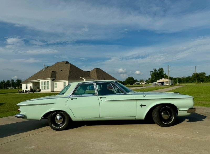

Very nice. I’ll take it it’s the one in your profile pic? I like that gentle rake.
I don’t mind the way it is now….but it does look like something my great aunt used to drive to the grocery store lol if ima put a poly stroker in it its gotta look a little more muscular going to the grocery store lol

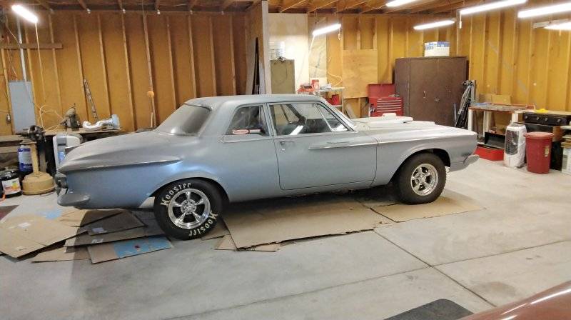

Pics are mine , with 456/457 superstock springs (not as bad riding as most believe) and slant six torsion bars.
The centerline combo is 10.5/28 slicks, 185/60 fronts (too short, needed tires,one weekend, all I could find for a 15x3.5 rim)
The tt2 combo is a 10" slick on a 8x16, and 235/75 on,a 15x7. The 235/75 will NOT CLEAR a stock opening. Mine has been "relieved" a couple inches, on both sides.
