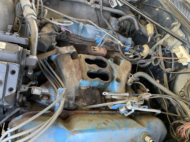

What Edelbrock do you have 1906? What adapter did you use Eldelbrock 2696? Where did you hookup the choke to?You think this a better kit?

Mr. Gasket 1932 Mr. Gasket Carb Adapter - Open CenterWhat Edelbrock do you have 1906? What adapter did you use Eldelbrock 2696? Where did you hookup the choke to?

Was the distributor hard to change? Looks like there is a air condition hose above it?Hey it’s all good, after a lot more research the 440-426 is exactly what you needed so I ordered one for my 77 Doba with the 400, Thanks
What did you do with the old EGR? Remove it and put a plate?not really sure. seems about the same.
ItWas the distributor hard to change? Looks like there is an air condition hose above it?
I ended buying the distributor from Jegs.Was the distributor hard to change? Looks like there is a air condition hose above it?
Mine did not have an EGR. It had an still has the factory block off plateWhat did you do with the old EGR? Remove it and put a plate?
What did you do with EGR?It

Very Very nice unit, it was a kit that came with everything.
The Transistor box was good to 7000 RPM and the distributor is about a 1/2 inch higher than stock which made it a lot easier to get the cap on, plus it is polished.
I think it was around 250 for everything about a year ago.
You do anything with the catholLucky you. Thanks!
You do anything with catalytic converter?It

You do anything with catalytic converter?Lucky you. Thanks!
yes, it was removed.You do anything with catalytic converter?
What did you set you timing at? It says 5degrees but can turn distributor that far hit touches manifoldHey it’s all good, after a lot more research the 440-426 is exactly what you needed so I ordered one for my 77 Doba with the 400, Thanks
What did you set your initial timing at?It
