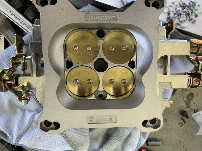

I have it 8 degrees and engine shakes a little. You think I need to adjust the timing or the new carburetor? I did not just the new carburetor at all.
set it on 10-15 and back the idle screws out a little and see if it clears up.
