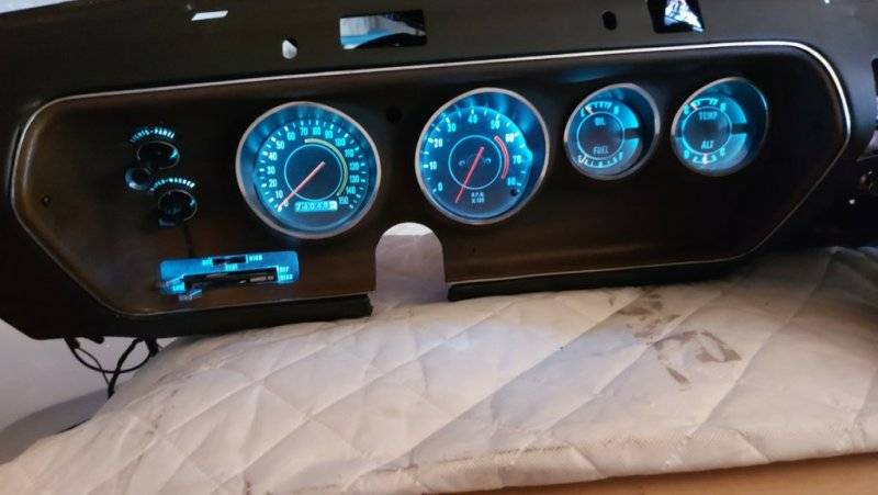

Looking for any feedback on replacing the factory bulbs in my '73 Charger Rallye dash with the LED (BA9s) version. Has anyone done this? If so what brand did you use? Are they dimmable? Are you satisfied with the brighter look?
Thanks. Did you go with a cool white (6000K) or the warm white (2700K) bulbs?
I used the cool whites in mine but kept the factory blue diffusers in it.
And no, they are not dimmable.
