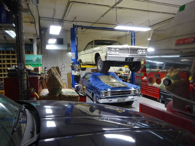

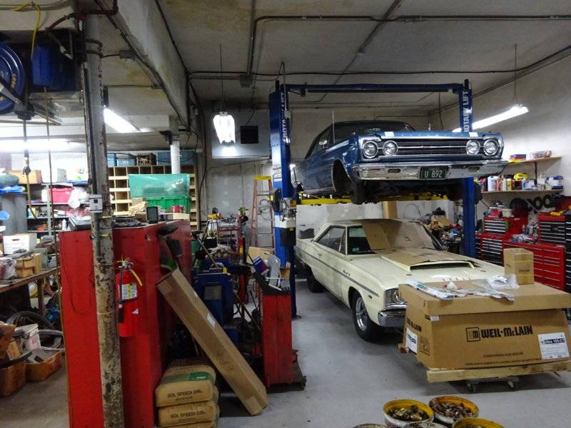

Working this spring on my 66 replacing wiring and dash parts, I got tired of not being able to see. After quite a bit of research, I came up with these:
https://www.rablighting.com/product/ARBAY4-175/LC
For efficiency you really want to look at lumens per watt. Most T8s are about 81 L/W which is really not that bad. LED T8 replacements are sometimes LOWER than t8s, some are higher, but you are paying on the higher end of the scale. These things are 134 L/W They are considered high bay, which is 15' or higher. I have 13' ceilings which means that I am on the higher side of low bay lighting. I chose the high with the idea of dimming them down if I had to.
Here is a before and after. You can clearly see the difference in the actual light, but for some reason the picture doesn't show the difference in real life.
These things are incredible! Most peoples reaction is "OMG they're blinding" then they realize its similar to working outside where your eyes get used to the light. No more using drop lights for brake jobs, and I can see well while working on the underside.
They cost a little over $200.00 each and in my state with rebates they were only $55.00. I may not have done them at over $200.00 but at $55 it was a no brainer.
I hope you were able to follow my thought process.
