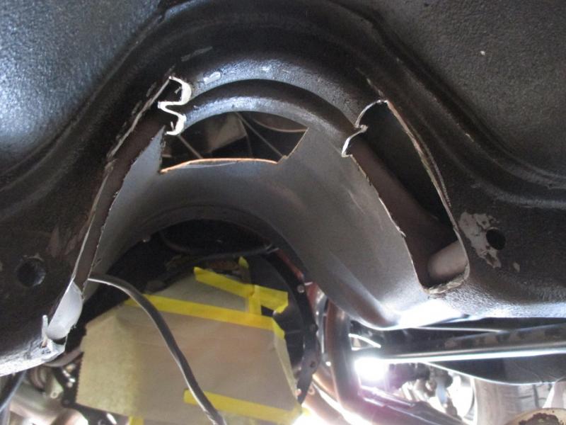

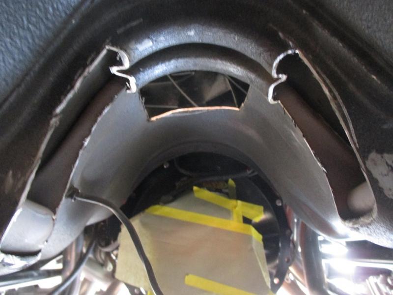

4. You are going to have to trim your floor and torsion bar crossmember a little bit. I had to put in a new floor anyway so it doesn't bother me. you dont have to cut the torsion bar crossmember hoop completely out either I will show some pictures of where needs to be trimmed. once i test fit the trans again i will box in the areas that have been trimmed.

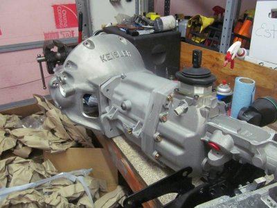

End of part 1 picture to follow.
that picture is not my trans but the exact one i am using including shifter position and color :)

the case looks like and evolution of the T45
Well the new 5 speed weighs 108 lbs dry. add the clutch and bellhousing and flywheel your looking at about 150 i would think.

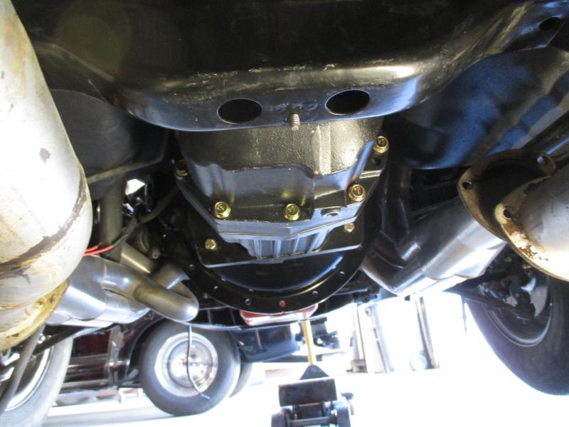

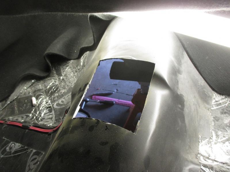

got it mocked up in the car

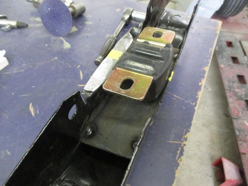

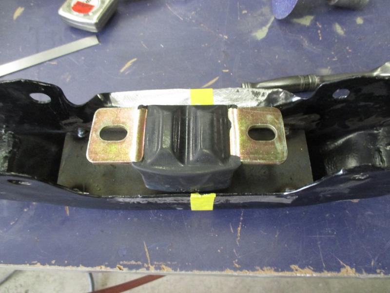

It looks like you reuse the original transmission support. I think with Kiesler they provided a new one.
Is there no structural weakening due to trimming that torsion crossmember? I am guessing not otherwise you wouldn't have done it.

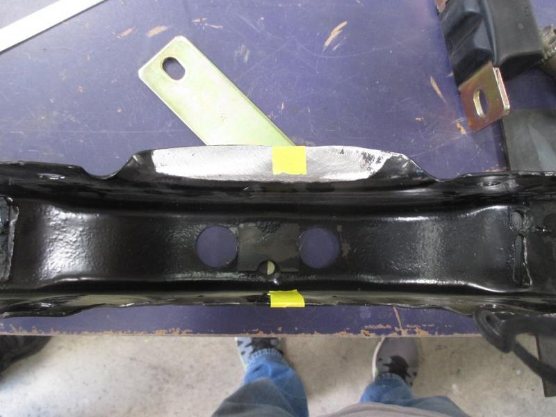

The Keisler crossmember originally lowered the trans by almost 2 inches and would have thrown the drive angels way out of balance. I will be showing pictures of my stock 4 sp crossmember and the modifications I had to do to get it to work. I stress that this project as of right now does require some fabrication. The areas of the torsion bar crossmember will be boxed back in after we remove the trans again.

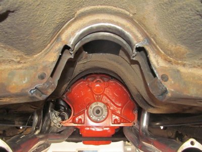

That looks familiar:IMG_1372.jpgIMG_1343.jpg
The speedometer cable comes out right in line with the T-Bar crossmember which is the biggest issue I had.

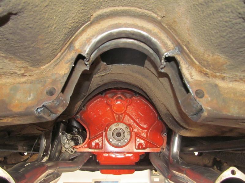

I boxed in the cut out section of the crossmember too, just didn't find a photo of that yet.

In the Moparts thread, the tailshafts were ground down a bit, and Keisler didn't like that, said it could weaken the part? With the crossmember cut, it makes the needed clearance so you don't have to modify the transmission.

Legend cut down the tail shaft area as much as they could. they also told me any more would have cost strength in the case.
Some photos of the trans crossmember modification.
