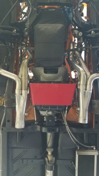

Figured I’d chronicle this build here. Probably a good opportunity to discuss what goes into a decent 727 build and discuss other builds as well. I could also probably use some help here & there.

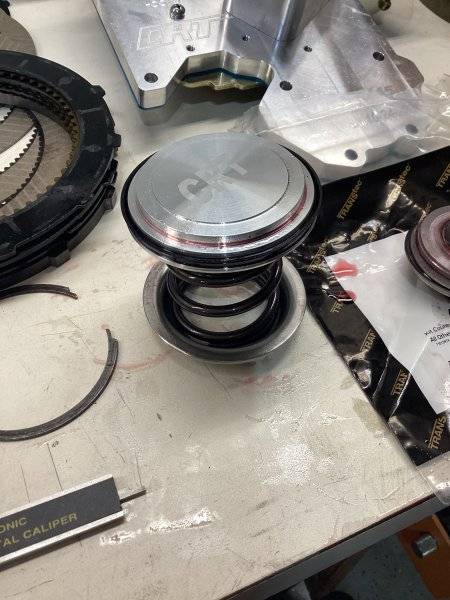

I’ve been a footbrake guy for years. And the 727 in the yellow car has long been pretty stock with just good quality clutches, a Turbo-Action manual valve body, and a Dynamic 9-1/2” converter up front. It also has a TCS bolt-in Sprag. This year I decided to take the plunge and invest in a brake. Along with that, we’re installing some good parts to help it survive. Among the changes being made:

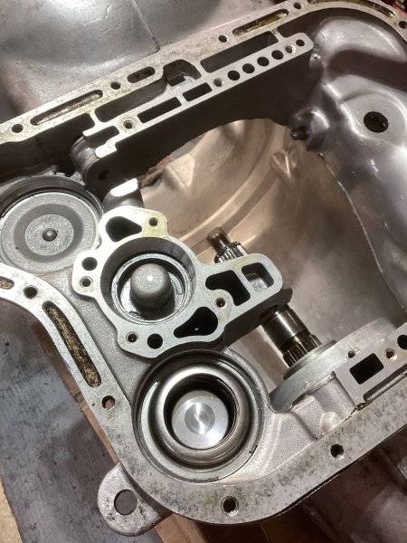

- CRT reverse pattern transbrake valvebody.
- CRT billet Alum. L/R servo piston.
- Late model pump stator
- Blocking rod in the accumulator.

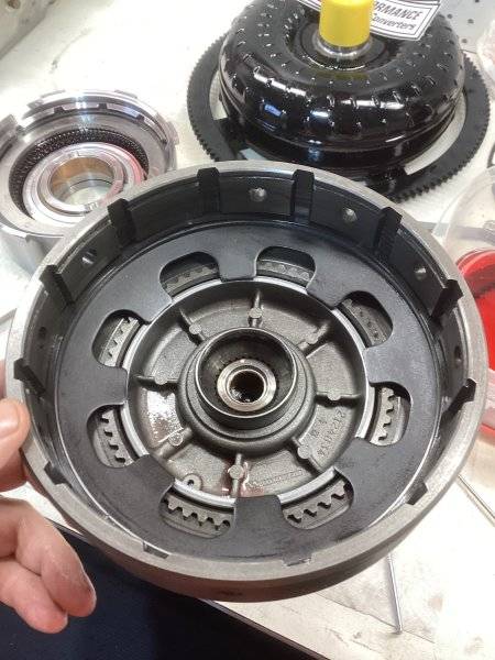

- A&A Ultimate Steel 5-clutch drum w/ 12-spring retainer.

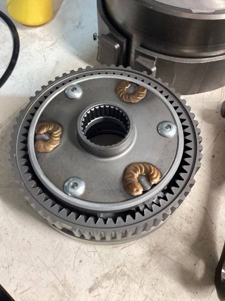

- A&A Steel rollerized front planetary.
- Goering Heavy Duty Belleville spring.
- Relocated case vent.

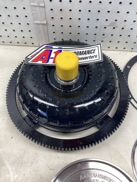

Additionally, the existing dynamic 9-1/2” Converter that was built specifically for the old 451, was sent out to A-1 Converters (local to me) for a full re-assessment and rebuild specific to the new 470 combo.

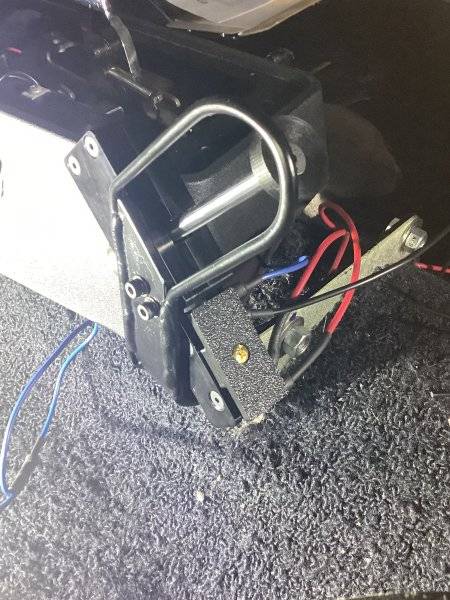

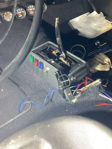

My right thumb will also now be getting familiar with a Cramsey Innovations Overthrow Button. This unit offers the maximum legal throw length, and Cramsey claims it can delay the leave by as much as .050.
Some evidence of the fun over here….

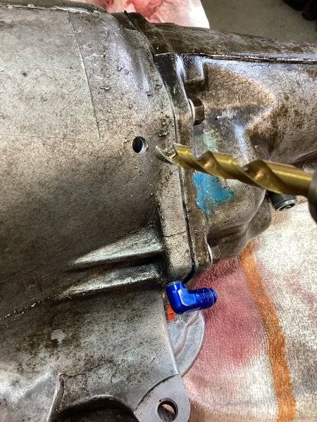

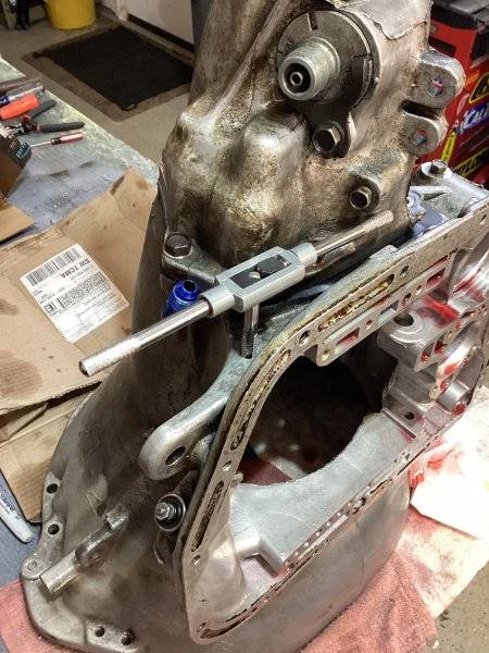

It'll be good. With the vent in that location run a push lock tube up to a small canister on the firewall. That way any fluid slung from rotating parts will return to the pan.
Doug
Doug
I thought this might be needed. It’s tucked in behind the overrunning clutch race, but you think it’ll still see a good amount fluid, huh Doug? Do you use pneumatic style pushlock fittings, or just an aluminum AN style fitting with a barbed push-on rubber hose? In either case, you tap the case for that fitting, correct?

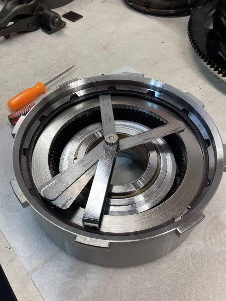

Also, I know you were comfortable with the .090 clearance I had in the front clutch pack. But since I was waiting on some other parts anyway, I ordered a thicker snap-ring; it’s now measuring .078-ish.
We always vent the case in that location. We have
never seen a significant fluid leak
out of it.
I have never thought to put a canister
on it but it is good idea especially if you every
overfill the transmission a couple quarts.
I've had others that had issues with slosh depending on location. either way with a puke can your covered. Mine is way back just above the fliuid return posrt from the cooler. I've been using brass/nylon push lock fittings with clear hose for years.
http://www.moparts.org/Tech/Archive/auto/9.ht

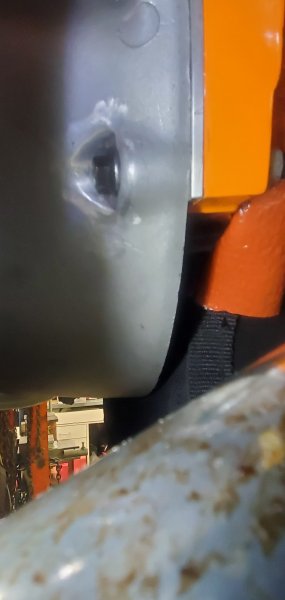

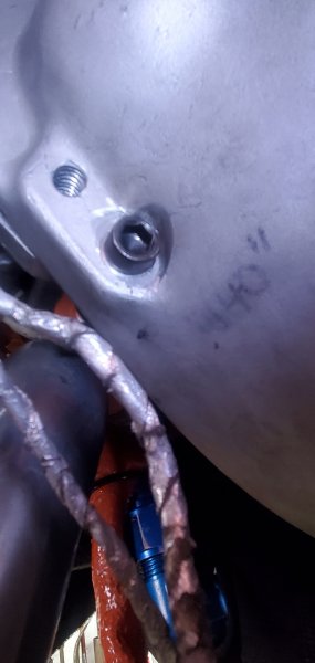

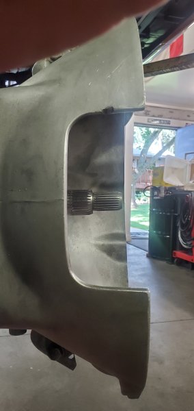

Three other things do. Hole saw the bottom of the bellhousing. Then connect the holes with a cut to make a clean conveter bolt access. Use a flat end burr and trim the case at the lower 2 mounting holes. Run a 3/8" drill thru. Then you can use small head or allen bolts from the case side to the block. Comes in handy when header tubes are in the way. Lastly cut the dipstich tube mounting bracket off. Fab a new bracket that uses the verticlal hole in the fixture mounting boss on the bell housing. Just slide the tube into the trans and rotate to your liking. Weld the tab to the tube. Super easy tube removal with shields and headers.
