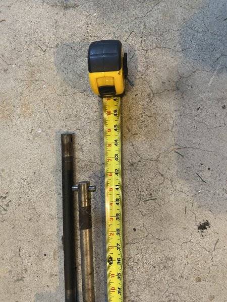

Yeah I also think they are the same. I will search all parts together and will do the swap then, no hurry. Can you might figure out how long both parts are exactly , if you have both of them?
When I have both of them side by side.
A member on here gave me these measurements.
When going from PS to MS, you needed an adapter that extended the steering shaft by 4".
