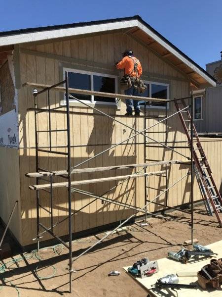

The pain has been what the canned contractor has caused. Slowly but surely we are getting past his boo-boo's. My coach was supposed to be here today so we could get the deck fascia started prior to putting the membrane on for the deck but he may have the cooties as he has a grandson over at his house thats be held away from another grandson who has the bug. Now he and the kid may have it. Hopefully not as he has prostate cancer which could give him an easier way to get ill. As I'm sure you have seen, people with underlying conditions have to be extra cautious. Hence another reason for my wife and I to hibernate and limit contact with others. We are going to do what we can while the fire sprinkler eggheads re-do their calculations on the main line instead of doing a quick field fix. Once the framer comes back and does some fixes, he can wrap/install siding. More lessons in patience!

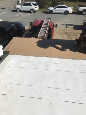

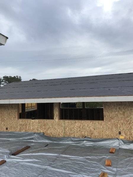

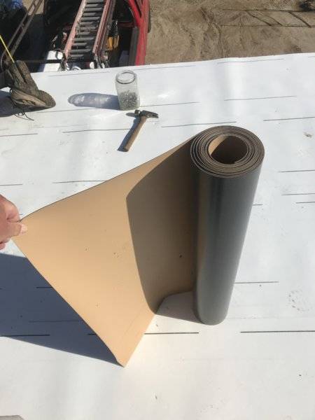

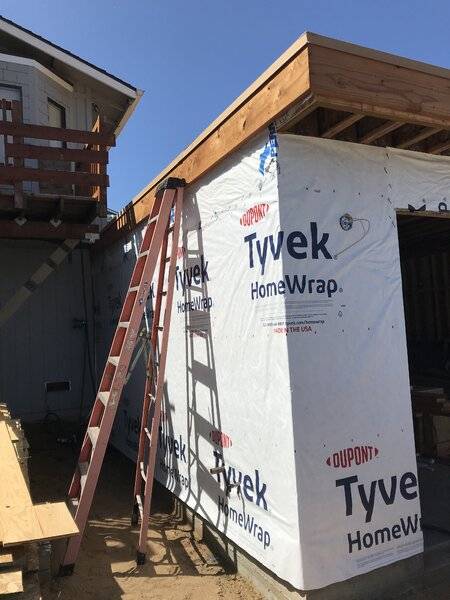

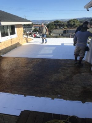

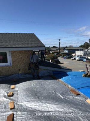

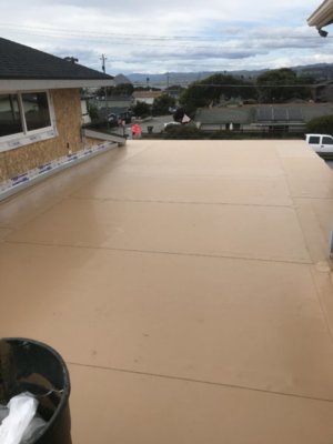

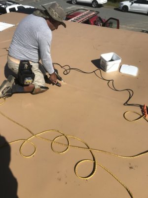

Slowly but surely stuff is happening. This week the membrane was laid down for the deck after my friend and I put the fascia boards on the week before. Don't need to put the tarps on anymore!

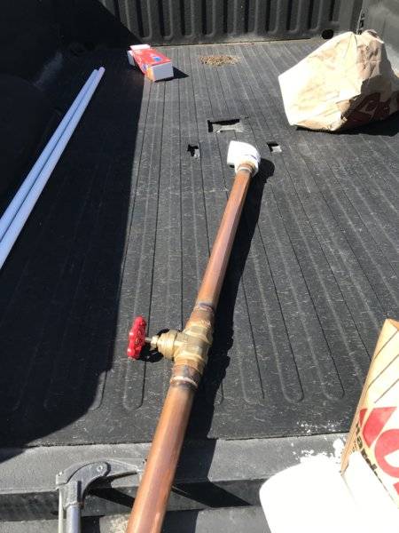

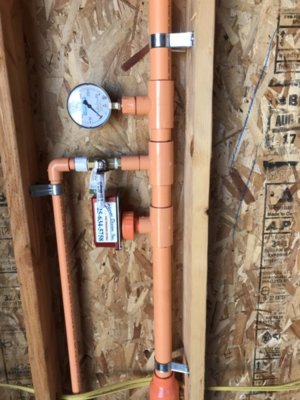

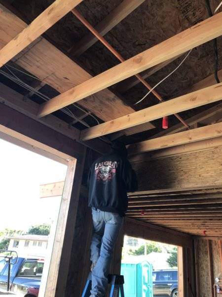

Time for some updates. We are currently in round 2 of the claim with the state board. The first one was just mediation and we got nowhere with the the prior contractor. Now its investigation time plus we have contacted an attorney and he will have an expert consultant come eyeball the project, go through invoices/log sheets/pictures etc. My wife has been burning the midnight oil finding statutes/codes/laws etc for the case which we will turn over to the investigators and attorney. News as it happens on that. In the meantime, the installation of the fire sprinklers has started. The plumbing is run in the new garage, house is retro fitted. The company has to do some more piping to join the systems. Old garage has to wait as its filled with stuff. Once the new garage is done I can move stuff over to make room so the unit can get plumbed and we get final on that inspection. Next week? I will pull some trenches and run the new water main to the house which also takes care of the fire sprinkler system. Have to get in touch with the water co. to have them swap the meter to a 1" outlet unit, currently its 5/8". At least thats no cost! The new main is 2" up to where the riser is for the sprinklers. The riser is 1 1/2". I tee'd off of the main to 3/4" for the new line to the house and will string out some more off that for some faucets on both sides of the new unit. A benefit of this new main line is that I can finally fix the F UP that the previous contractor did when he capped off the water feed line to the house, it is under the slab now, and re route it into a new spot on the house. When I go under the house for that side, I'll hook up our Ecowater system and have filtered/softened water in the house plus one outside faucet for car wash duties. The boob contractor did a bypass with a garden hose from the east side of the old garage to a still existing faucet that was tied onto the house feed. This has been our water feed to the house since september. Its non potable water since its run through a hose. Thank you ex-contractor! This was also one of the complaints on the case. The framers have been here since wednesday wrapping with Tyvek then hanging siding. Looking way nice. Once the siding is on. I'll dig trenches for the water line and we'll get on the painters schedule so it and the house can get painted. I made up the last two fence panels along the street. Put the first wave panels on. Looks nice.

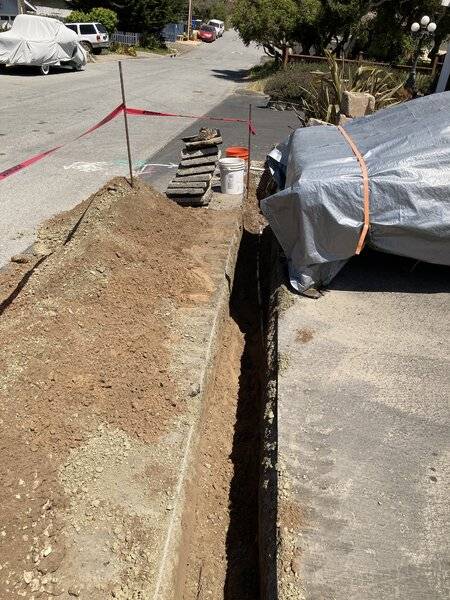

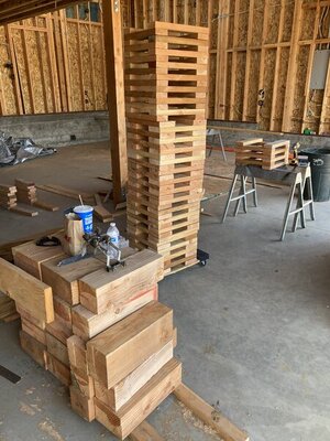

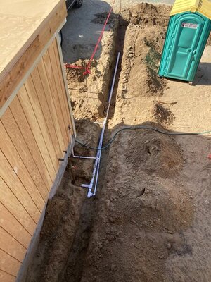

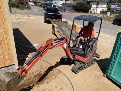

Dug some trenches this week for the new water lines. I have most of the lines done except for the last 4' to the meter. We are waiting for the local water company to switch it, luckily no cost, then I'll finish the lines. After that, fill in the trenches. My wife dropped off a 6" thick binder of paperwork/info/photos/timelines/codes/laws etc to the attorney this week. We are waiting for investigators to come and eyeball the project so we can continue with the case. I managed to cut up a lot of the excess lumber and make 3 sets of wheel/tire stands plus I had already cut up the excess posts and beams to make the ever needed wood blocks.
I got the water lines done, purged and good to go. The fire sprinkler company got the under house portion done so I was able to get the partial ok on last weeks inspection. The insulation company comes in for their portion next week, trying to get on the dry wall companies schedule for the week following as there has to be an inspection done once the insulation is done. I had been waiting to hear back from a civil engineer on a storm runoff pit/tank design for the back yard. After hearing 3 weeks of crickets, called/texted/emailed, I decided to cut him loose. After talking things over with the inspector, he came up with a much simpler design that serves the purpose and will work with the flagstones to be used for the walkway around the garage. The flags will sit on top of a rock filled pit that the drains will dump into. Way cool of the inspector to help on a quick low tech solution. I'll have a case of cold brews ready for him when he comes back for the next inspection. I am moving things out of the way in preparation for the next series of subs so there won't be any obstacles in the way.

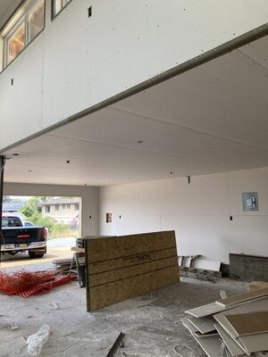

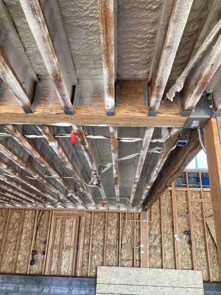

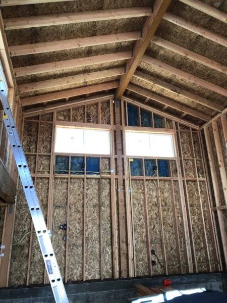

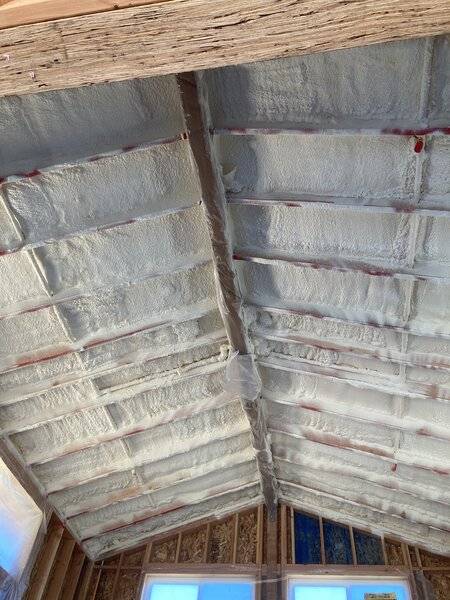

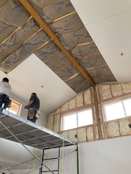

A company out of the valley, San Joaquin that is, shot the spray foam insulation in yesterday. Tomorrow the bats get put in, schedule next inspection for thursday, then drywall starts next week.

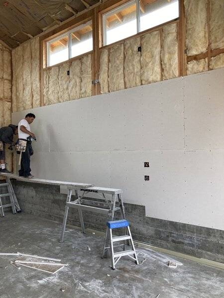

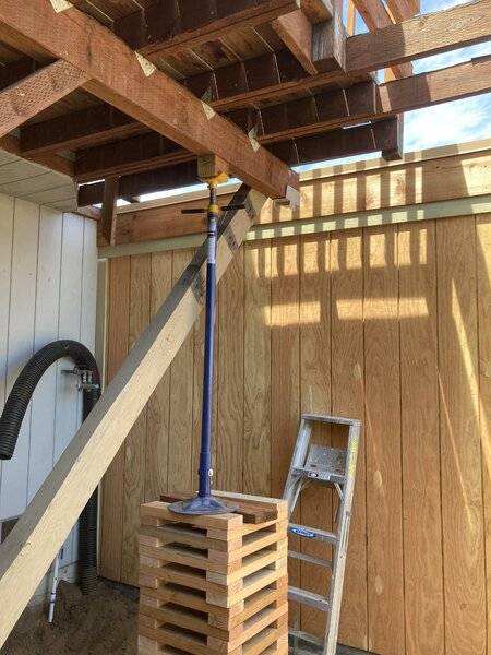

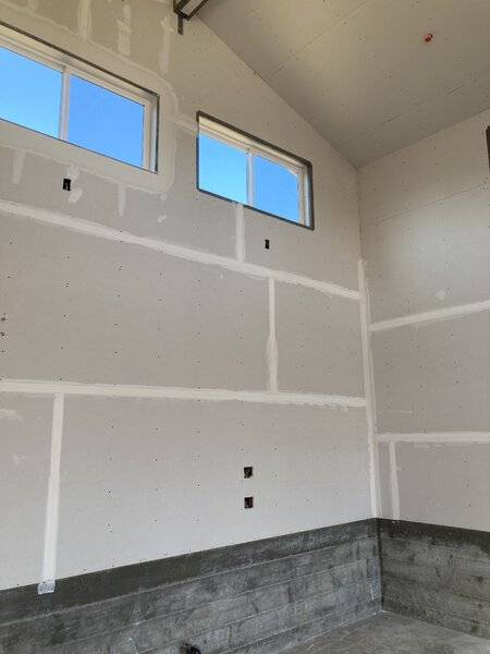

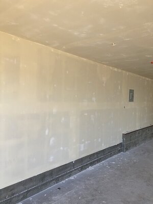

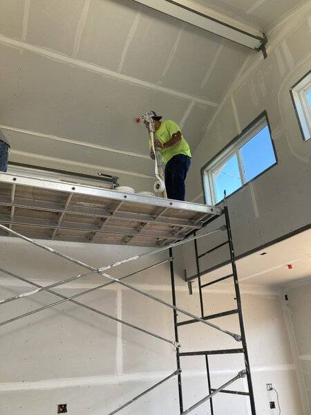

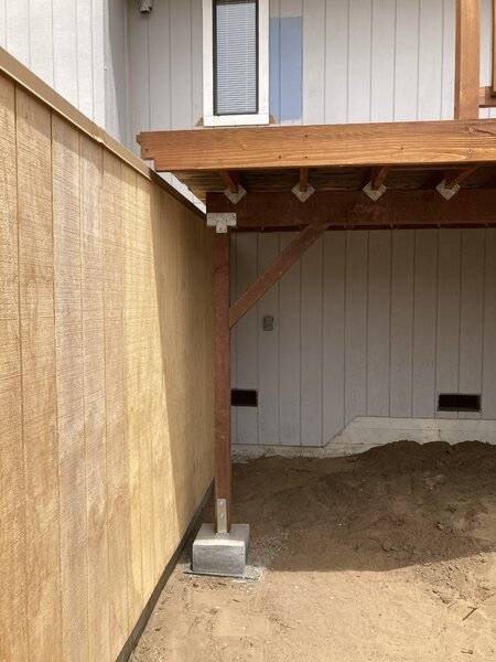

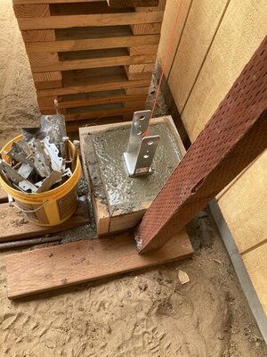

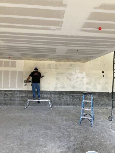

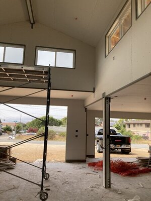

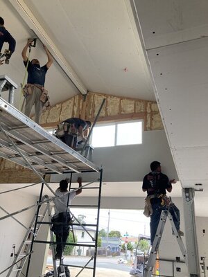

Mud and tape have been happening. Should be done next week. Drying time is a little long due to the cool/damp weather thats been happening lately. I poured out some piers so the ends of the existing deck can have its supports back.

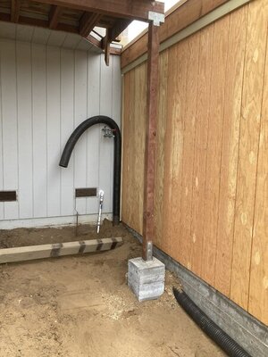

More mud and tape yesterday, should be the last load. They applied the texture, which is mostly just smooth with some craters here and there. Next week they'll sand and then it will be paint time. I installed the two posts back under the decks onto their new piers. Put in one of the gutter drains before I started bringing in fill sand to replace what was taken out from the excavation.
