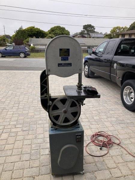

I scored a Delta band saw from a guy for free. It's an older unit thats USA made. Been wanting one for a long time.

Well, if that bandsaw is any indication of your luck, you should kick *** in court!

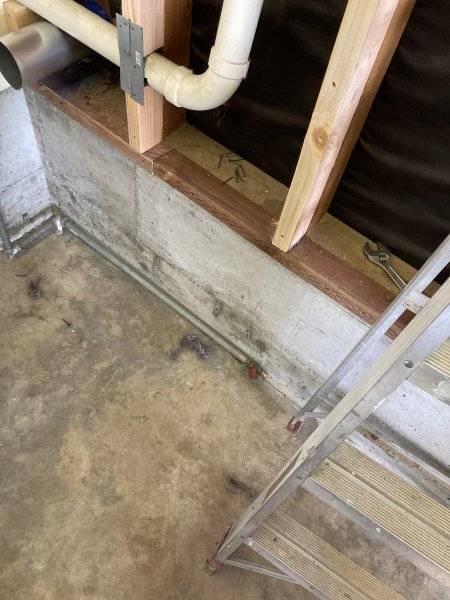

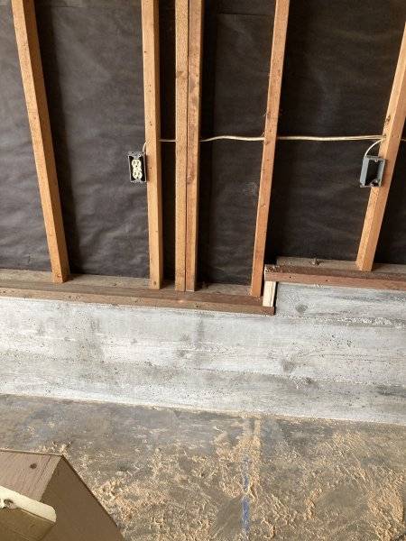

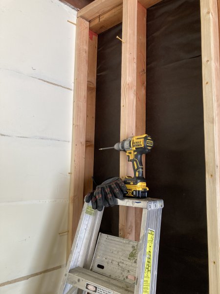

Yesterday I picked up some lumber for the old garage. I need to at minimum drywall the lid for the sprinkler permit to be signed off. I'm adding material to the existing studs to flush them out with the foundation as I'm going to drywall all of it. A sparky who does side work will be coming by next week to go over what I want him to add/move before it gets covered up. Sometime down the road we want to convert it to a short term rental so we want to get most of the background stuff done beforehand. The wall that butts against the house is the wet wall so it can stay as is for now. I measured out for can light placements, have them marked up to with tape and will be able to find where the wiring is later because I drilled short holes in the slab, marked with a small amount of pink nail polish and can use my laser bore sight to let me know where to go. I'm not sure if I'll do all of the lights now as I want minimum there when the inspection gets done and don't want to tip my hand. Once the sparky work is done, I'll get a couple of spray foam kits from HD and do up top which is also the back side of the deck. From there batts too in that area plus the walls. They did the same setup on the new garage. After than, drywall time. Today I cut up a bunch of the material to fill in. Got pressure treated for the plates so no change there. A couple of weeks ago I moved the items out of there over to the other unit. Started installing the cut pieces today.
I have about 75% of my wood butchery done in the old garage now. I made some nail plates using some seismic straps I had collected, cut them down to 6" pieces and got them in place. I need to work around the garage door as the way it's placed, I can't space it out otherwise it will hang back from the opening too far. I do need to get it partially disabled where it hooks onto the deck floor joists. When they come by for that, I'm going to ask if they can flip side to side the main brackets in the upper corners as this will free up some space for me for adding more material in prep for drywall. I have one section on the south wall by the door I need to bump out as when it rains, water comes in at the sill. That portion was replaced before we bought the place, due to dry rot etc. I'll bump it out, trim it a 1/4" or so to give it a little more space by the slab, put some flashing down that I bent up using leftovers from my fence, get some sealer down before the flashing goes in to seal between it/slab/sill plate, foam the inner space on the door thresh hold unit as water gets in there too and then back together. Since I had to move the dryer to get into the corner, replaced the dryer ducting and vac'd out the piles of dog hair that were under it. Ffn furry love gets everywhere! I vacuum in the garage periodically but was amazed that those big clumps didn't get pulled up when I put the nozzle at the appliance bases to pull stuff in.

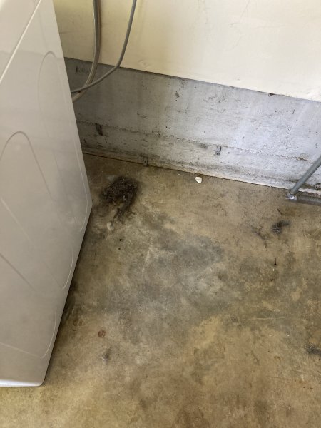

My dog sheds so much we could knit an entire other dog out the hair. She's an Alaskan Shepherd. 95 pounds of fun and energy.

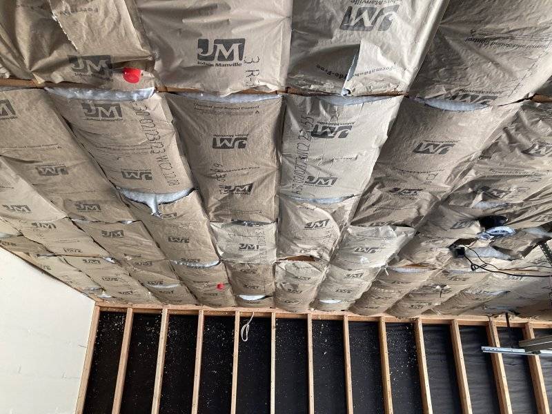

Today I wrapped up the insulation of the lid. I wanted to foam it before I put the glass in, which is what was done on the new one, but it turned out to be a $400 disaster. Operator error or other issues. Got almost as much on the floor as the lid so I decided to stop hemorrhaging money on that. Will take the other foam pack back to Depot for a refund. I'll also be able to take one bundle of glass back too since I had plenty by using some of the scraps in narrow areas. The drywall will get done mid next week so from there I'll get the final inspection done and the project which started in 19 will be done. The wiring for the can lights is in behind the glass, I have small holes drilled into the slab marked with pink nail polish so I can sit my laser bore sight there and point right where the rock will need to be cut for access. I am one tired dude after the last couple of days. Tomorrow is car day so I'm spectating the yearly show at Pismo Beach.
