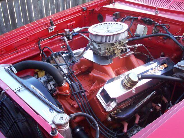

Bet That nice 440 set up would bolt-up nicely in Sonny's '63 :eusa_think:Belvedere!....
I am praying someone would,.. (just like yours),.. would give me one.
then I could clear the air!

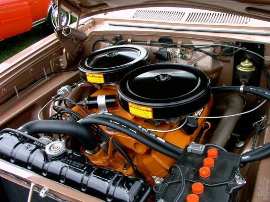

I can understand the driveability problems with 13.5 comp and the crossram back in the day. Guess thats one reason I dont know if I will ever put the crossram on my street car. Today with nice aluminum heads and the technology of cams and intakes you can have a nice fast driver. With the Indy dual plane and the Indy EZ aluminum heads I run 10.6 comp and good quench to run on 92 pump and have a nice sounding and driving wedge eng thats drives so nice I can cruise all day in it with no plugs fouling running a single 850 DP and run 10's thru the pipes and have a nice driver car. But the crossram sure does have one heck of an impact when you see it under the hood on a Maxie car. I give up the cool impact of the crossram on mine to have great driveability. Guess its hard to have both but I have seen guys run the crossrams today and drive them on the street. Not sure how good their driveability is though with the crossram and dual Carters or Eddy carbs. Ron
But I do love this look ! Ron

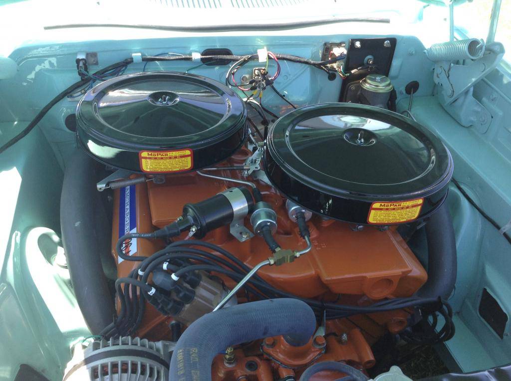

I have no problems driving this on the street, starts okay with no choke. Give it a minute or so to warm up and off you go. 511 cubes, 10.5 to 1 comp, solid roller cam, pair of original 3705S carbs, 3.91 gears. Modern ignition and converter certainly help. Don't be scared of the crossram.
