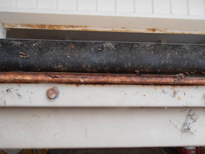

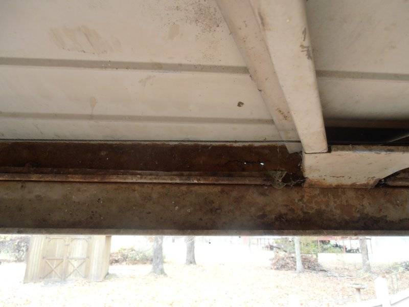

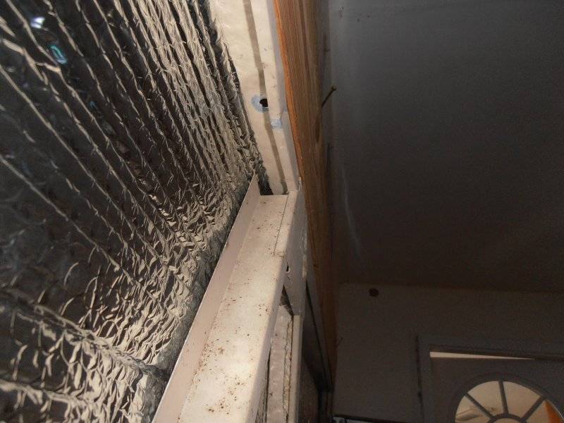

This isn't a car discussion but it's a subject we're all too familiar with! This is the bottom of my garage/basement overhead door, as you can see there's some issues that I want to address before putting bubble wrap on. The first 3 pics are from the inside bottom, as you can see the center has been eaten through. The rust has crusted the nut/bolts that holds the weatherstrip trim piece so it's lookin like those will have to get ground off, and have to use sheet metal to fab that piece that holds the weather strip as that's pretty trashed.
I have some POR-15 left over from a different project, should I use that or get some SEM rust-mort and go over it with that? Maybe do both? It doesn't have to look good, just better and stronger than this. What do you guys think?
scratch the shale off with a wire brush or wire wheel brush. Get off as much as you can for a more effective result. Then brush the rust mort on. If you have access inside. Use a squirt bottle with rust mort , spray the inside if you can. Leave for a day. Wipe off residue with a damp rag. Let the moisture from the damp rag evaporate . Then apply your por 15 . Both are great products.

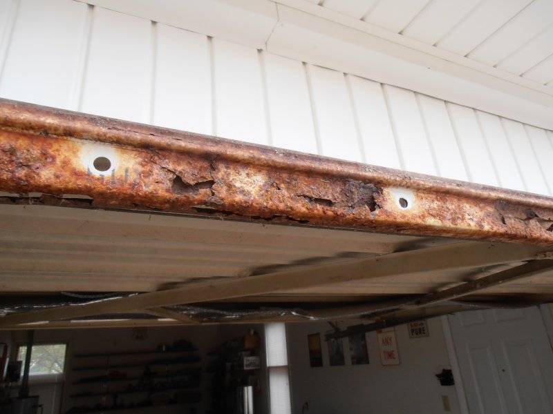

Lookin like I'll have to do some fiberglass repair/reinforcement as well! All this is from over 50+ winters of condensate on the inside of the door! The fun of home ownership! Snapped all but 2 bolts, so that was easy!

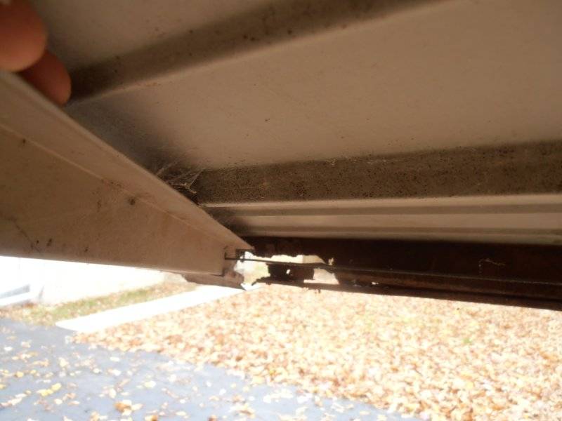

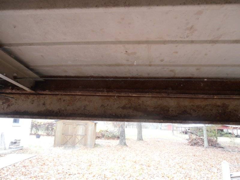

BTW, where's the rubber seal on the bottom to keep the wind and rain out?
See pics 4 and 5 in post #1.
How old is that door? They haven't used that seal in 30 years. The modern seal is rounded on the bottom.
House was built in 75, and the rubber seal shows its age. I'm just really surprised that the removeable trim piece is in such good shape compared to the bottom of the door. Hope these pics help show what I'm up against.
This is the bottom with trim piece removed.
Closer shot! I've already hit it with some POR-15.
This is the top, what the bottom should look like.
Outside bottom with trim removed.
