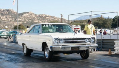

I use the Calvert 90/10 shocks on the front. I drive it on the street, even some twisty mountain roads on the way to the track and they work fine for me on the street and on the strip. My car runs 7.90s in the 1/8 so it's probably about the same as mid to low 12s. launch_zpsd8cbe585.jpg
