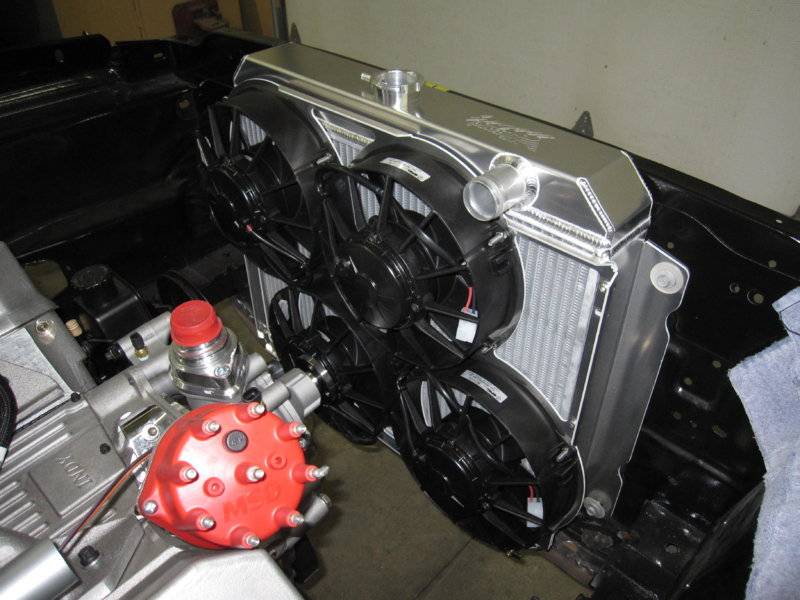

I've been using Be Cool w/ their dual fan set up. Zero issues. But expensive.

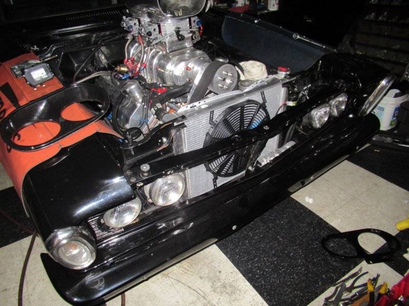

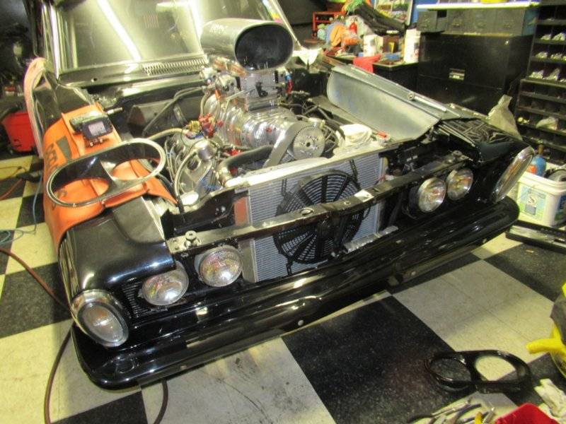

I used a $200 Afco 3 pass aluminum radiator with a $135 SPAL 16 inch fan.

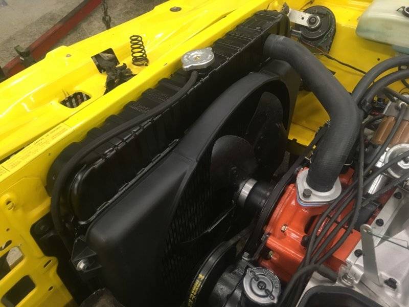

Glen Ray for me. Stock rad with the max cool package and a 7 blade fan. Idles at 180-190 on the hottest days in traffic, all day and looks correct with no overflow hose swinging around and all that nonsense. Cheap aluminum radiator I had ran hotter than this rad. Big power, big money radiator= no *** puckering moments in traffic or idling.

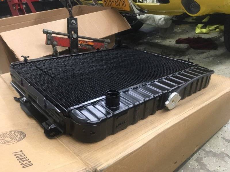

Stock. Nothing better than Ma Mopar Copper for me.

Wizard makes some great stuff.I have used their products before. That's if that is your style. BUT for me it's factory copper. I run a E body Hemi rad in my 65 with a factory clutch fan.
