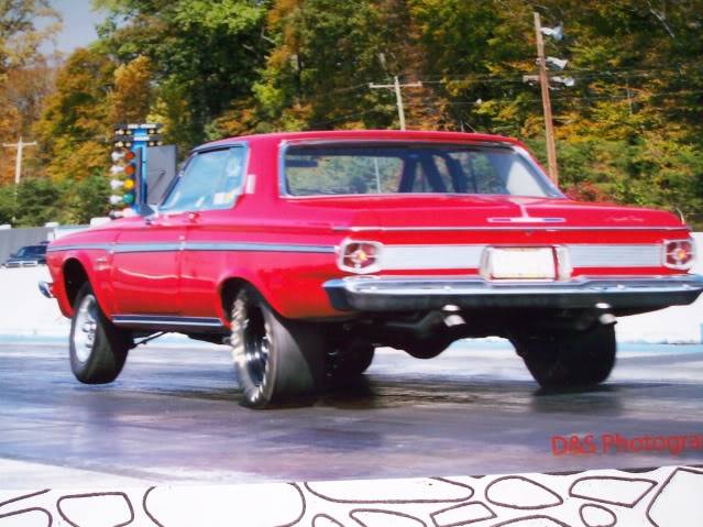

I can tell you what I use on my 63 Sport Fury street/strip car. Basically my suspension is all stock. I rebuilt all of the suspension with new stock parts. I use the factory 383 torsion bars with Comp Engineering 90/10 drag shocks up front everything else is stock up front. Out back I use 3400 lb SS springs I bought from Mancini and I have the longer C-body rear shocks. Thats it ! I have frame connectors on the car with a 6 point roll bar and I use Hoosier 30 x 9 radial slicks. Best 60 ft is a 1.50 with 10.70's @ 125 my best et's so far. My 60 is not the greatest but its not bad either as it is about average for a 10.70 car that is a 99% street car raced thru the pipes on pump. I enjoy it as it drives very nice and has no problems at all and did not cost me an arm and a leg. Simple and effective thats what I like. Ron
