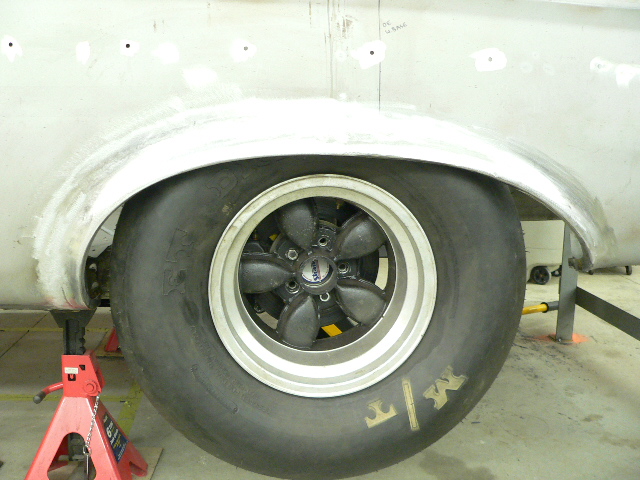

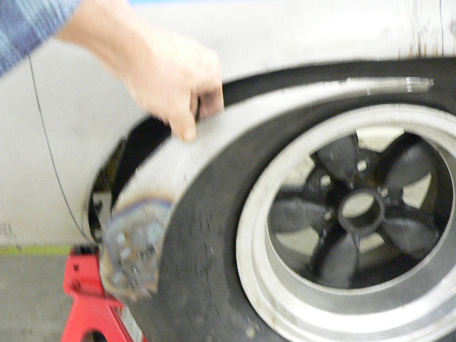

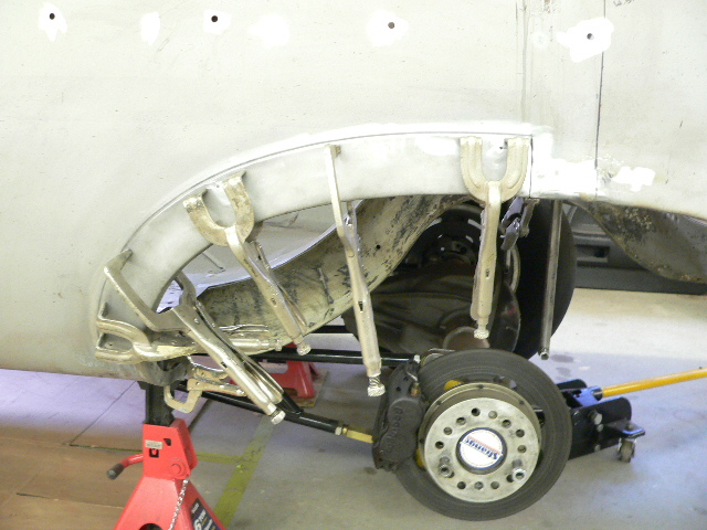

You're running 31-10.5W Mickeys.... What back spacking are you using? We're running 29.5-10.5 and I would like to go to the bigger tire.
You coming down to run the Curt George Memorial race in Salem Ohio in August?
I would like to be able to run the N/SS 9.25 AFX index. Eventually it sure would be nice to get a 8.99 but that's a ways off. The 10.5x31 will fit the stock wheel opening but it's very tight. Mine are stretched 4". I believe my back space is 4 1/2". I made my own width axle to fit the wheels. Its narrower than stock. I would love to go to Curt's race as he was a friend of mine. Just depends on scheduling and if the car stays together.

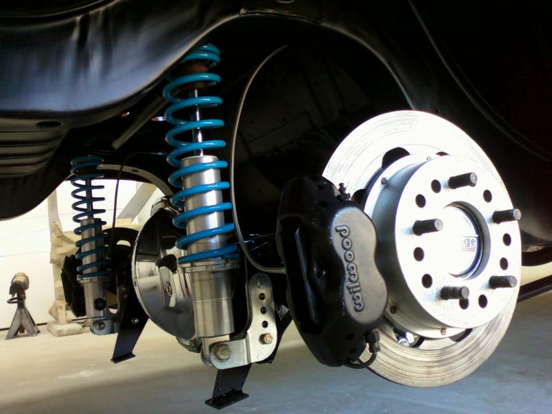

Sounds like it's going in the right direction for sure! Running as good as it looks! One thing aren't the calipers suppose to be mounted on the rear of the housing? Hope to see you at some of the N/SS races this season.
Though it really doesn't matter, they are on the back. That was a mock up picture.
Doug
