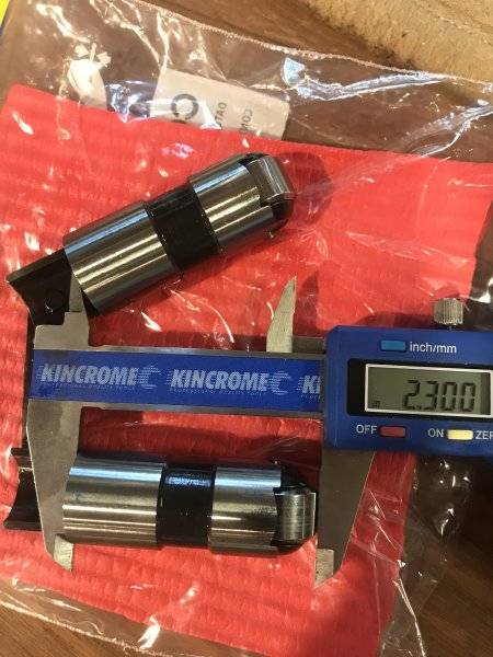

What’s the length of the roller lifter? Do you have Comp’s item number?
I can measure it tomorrow. I don’t have the item number because the engine builder has not given it to me and I can’t get hold of him.
According to Comp's site, all the specifications between small/big block hydraulic roller lifters are identical in measurements and have a height of 2.300".

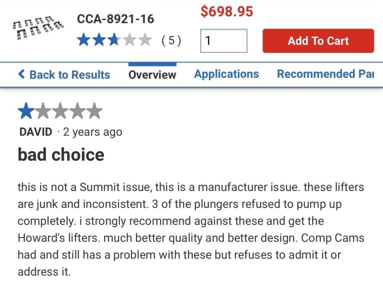

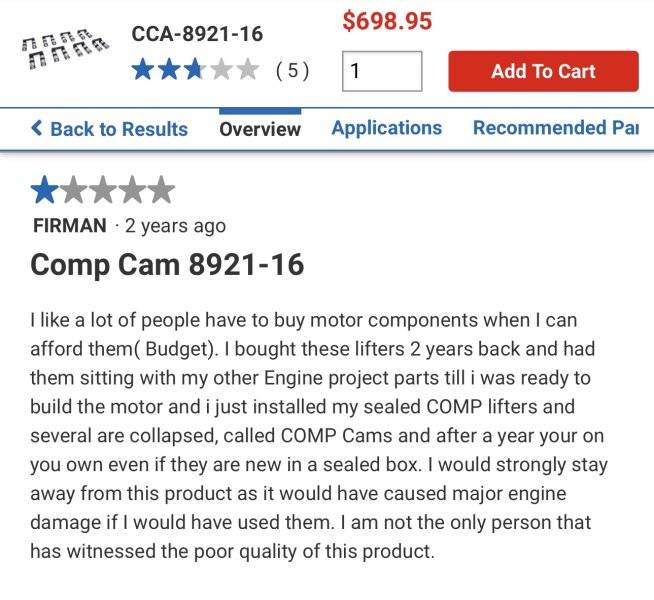

I have heard mixed results of Comp's hydraulic roller lifters collapsing/failing in the last several years for other makes - but I apologize as I have no facts to back that up.
