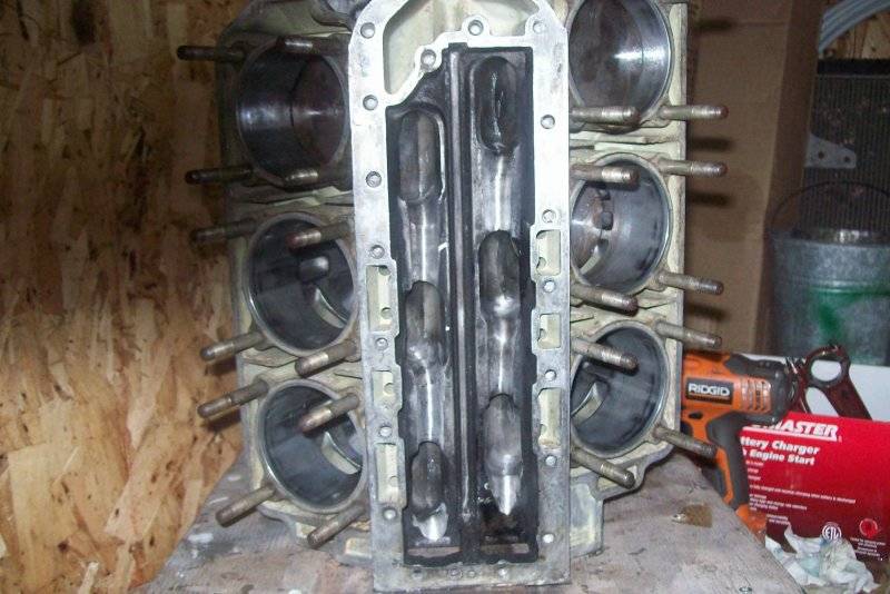

440 is childs play, when you have to do your timing with dremel tool it's do or die! 102_0011.JPG
