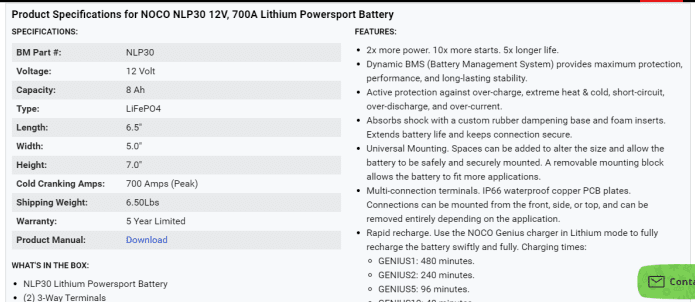

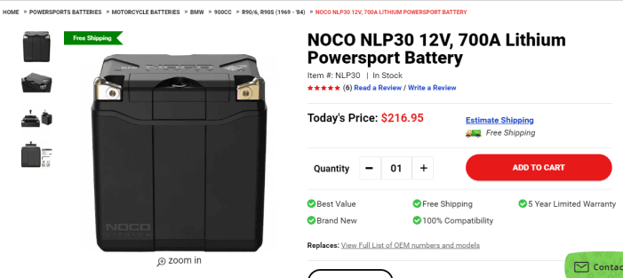

I hope you didn't buy this one. It's for motorcycles. 6.5" x 5" x 7"
That was my first impression also, but 700A starting is 700 amps, no matter what it is in. In my case it will be in a track car. were every pound counts.

Since this is around $200 and since a regular car battery is about the same price, this is a tempting option. I moved the stock battery to the trunk to clean up the engine bay but doing so added a lot of weight. The group 24 size batteries are what...40 lbs? Add in the extra length battery cables and ground straps and I may have added 30 lbs of weight to do it. Going back to a battery in the engine bay while using a 7 lb battery could mean a weight reduction of 60-63 lbs!
I don't see the value if the battery is $300 or more but if you need a battery anyway OR if another car of yours could use your existing one, this is interesting.

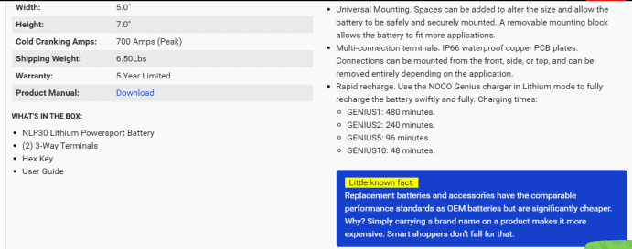

The 5 year warantee is a plus. The reserve capacity of 8 AH is pretty low. It better not have to crank long or run anything with the ignition off. Better have a ggod alternator.
Doug
I agree, it is NOT IMO best suited capacity wise for a daily driver application in the size first mentioned here.
