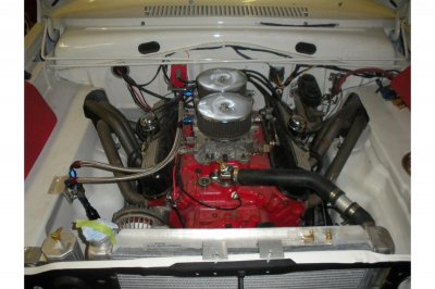

Little ól 273, what kind of power?
Here's mine
My 273
Looks mighty cool!

Oh yeah, could´nt brace myself the other day.
Heads are empty, just had to hang it together to see what it would look like.
