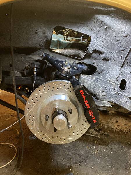

Fought the headers and steering box so I could finally finish the drivers side.
