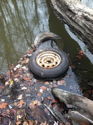

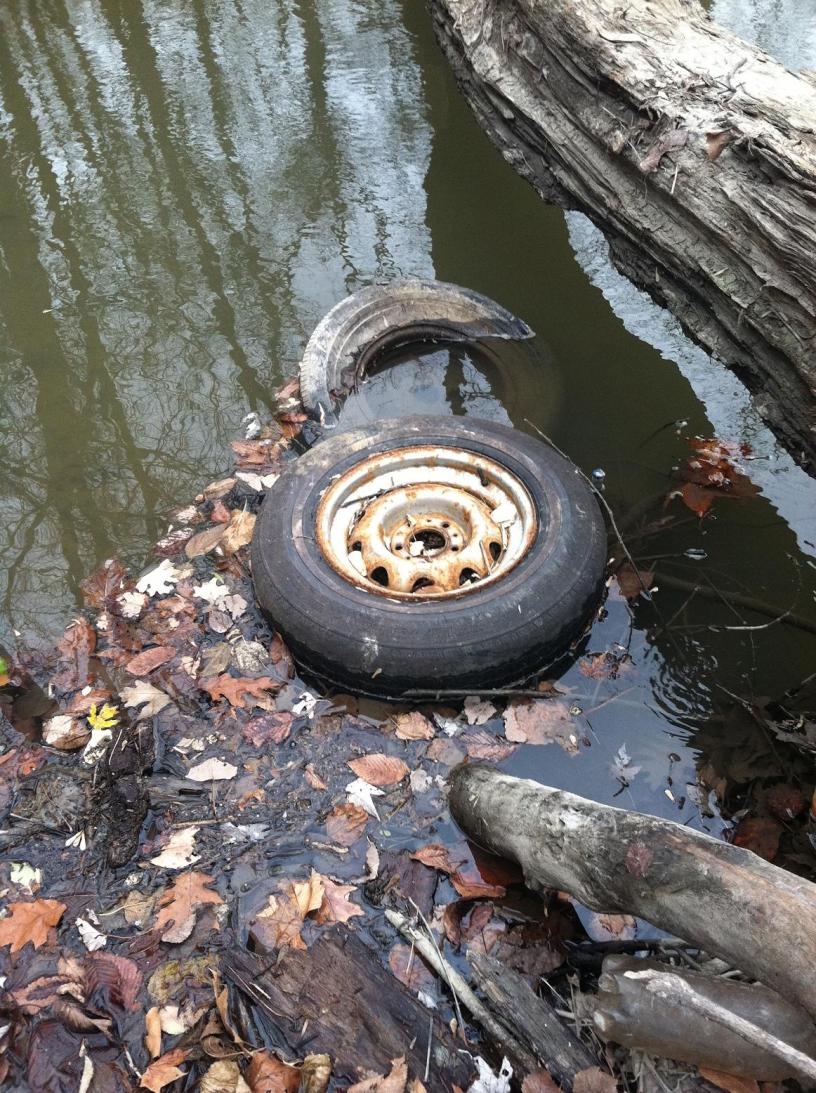

Was out in middle of nowhere today and spied what looked like a mopar rallye wheel floating on edge of river today. Thought to self...hmmm wonder if 15inch. Guess what? Sure is. Was not able to snatch up due to other circumstances but going back tomorrow to get...IF still floating there. If this wheel and tire could talk.

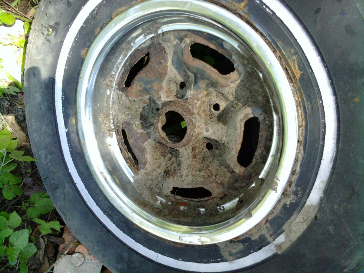

funny story. same kind of thing happened to me once. walking through an old scrap yard i found this wheel buried in weeds. i dug it out really quick because i thought it looked like a 1969 "W23" recall wheel. after further inspection i don't think it is. shame too, thought i might have struck gold.
