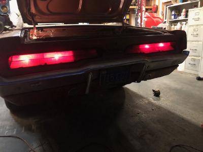

Anyhow, the car starts, stops, runs and drives just fine. The gauges work, the lights work. No horn though.
It does have a Salvaged title so it will need some manner of inspection process before I can title it.

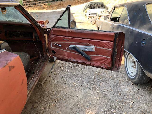

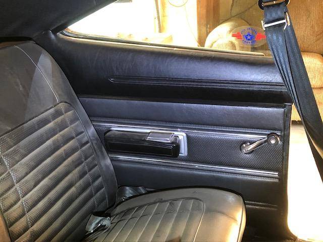

Jigsaw is an XH model though....these were the cheaper and more plain Chargers for 1970. Bench seat, column shift and no upper door pads:
Compare that to the Charger 500 and R/T models....
All this stuff adds weight.
The 383 weighs less than a 440 so I suspect that the car might be around 3700 as is. I do have frame connectors and torque boxes in this car too.

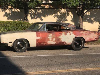

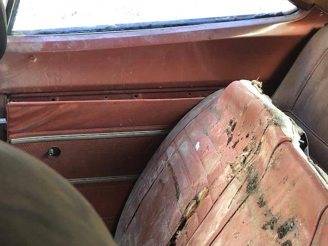

The car was in a parking lot speed collision way long ago. The RF frame rail is bent upward as seen in the pictures.
I had to put a pair of '73 Duster disc knuckles and rotors on it to make it a roller. It might have been a disc car, I don't know. No fender tag and so far no build sheet.
A base model Charger, but someone splurged and got the 383-2V and passenger side door mirror!
Did you find the build sheet, or remnants?
It's getting near time for you to lose the General Mayhem look,and prime it all one color! They have tinted hot rod primers out there in many different colors. Having many Chargers It's nice for a car like this to be the recipient of hand me down parts as you continue to upgrade your red Charger!
Many years ago I had my yellow 70 Charger R/T and another 70 base model Charger, and I primed them both black with a white tailstripe,I put the R/T door scoops and taillight trim on it and the same magnum 500 wheels so they were twins. At the time the price of gas had just gotten over a dollar a gallon, so the 318 Charger was my daily driver, and the 70 Charger R/T was my weekend cruiser,but only one of them was registered, and when someone wanted to race,I would tell them I had to get gas and I would be right back,and go swap the plates onto the R/T and come back and race them! It was a lot cheaper driving the 318 Charger at 15mpg,verses 7 mpg with the R/T. lol
There were shreds of one in the rear seat cushion but just barely a corner was all that remained. No fender tag either. The XH29L0G VIN shows it to be a 383 2 barrel. The 383 engine that came with it has the last 6 numbers of the VIN on it.

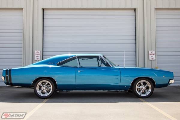

I've always loved B-5 blue. A few years back I was considering the possibility of taking the red car apart to change colors!
Blue and chrome looks great to me.
I'm certainly fond of my '70 EB5 blue Charger.
Great choice!
Chrysler made some outstanding blue colors, and they really pop with all the beautiful chrome they out on their cars!

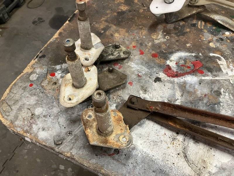

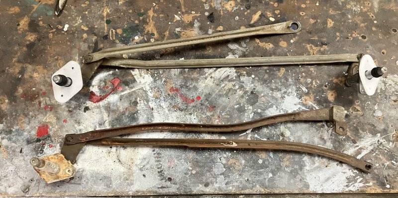

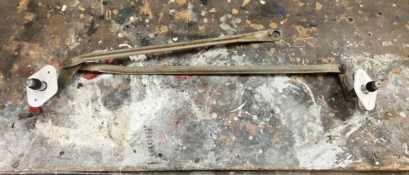

Today I’ve been messing with the wiper linkage.
The right side pivot and arm were missing from long ago. I’ve looked at swap meets for the arms but had no luck. Looking at my red car, it seems like they are the same on both sides. 15”, right ?

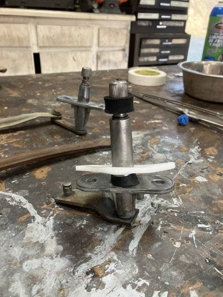

Last year at Fall fling in Van Nuys, I bought a set of linkage from a guy that said it was for a 68-70 B body. I just cleaned up the pivots and put the new foam gaskets and donut seals on it all.

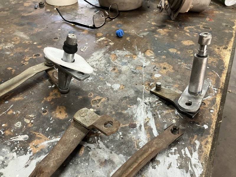

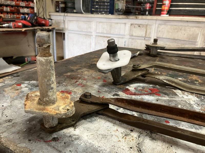

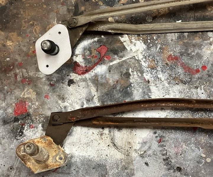

Then I pulled out the incomplete linkage from the car.
Oh oh…. I see a few differences.
The bar to the right side is too short, the main bar is also, plus they are shaped differently. Plus…
The pivot is way too short.
The dude sold me the wrong stuff.
Last year at Fall fling in Van Nuys, I bought a set of linkage from a guy that said it was for a 68-70 B body. I just cleaned up the pivots and put the new foam gaskets and donut seals on it all. View attachment 1381634

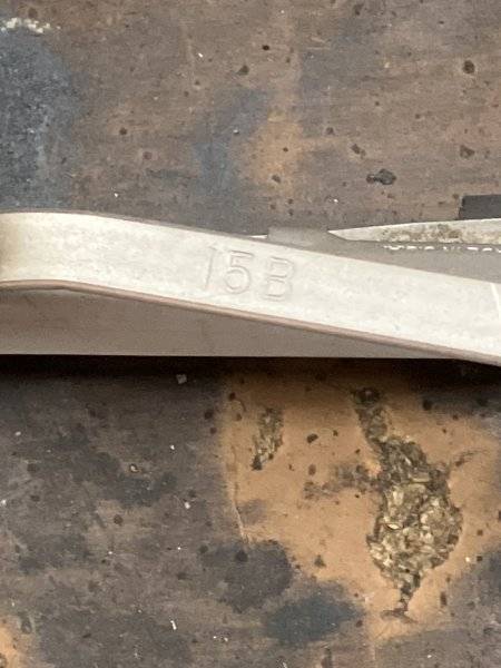

I see the 15B. Some of this has been discussed before.
Post in thread '1970 Charger windshield wipers' 1970 Charger windshield wipers
I have never had the linkage out of the red car to be familiar with it.
This reminds me of when I bought a 73 Challenger back in 2002. It was missing lots of E body specific parts and I had to track a lot of things down. I didnt know of Internet forums then so I had to rely on face to face advice on what parts were right.
Back on point:
I looked through the shed and found some more stuff.
I may have what I need.
Mine is still in the car. Otherwise, I would measure it and post pictures.
