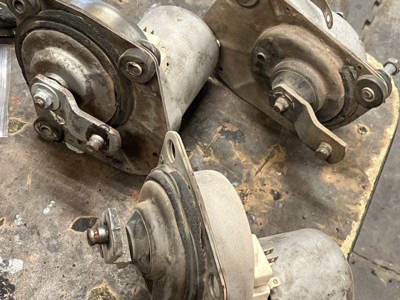

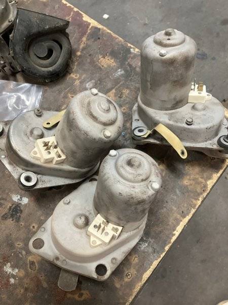

I have a couple 3 speed motors. Ginger has a 2 speed. I want to flip- flop the cars so Jigsaw will have the 2 speed setup. I have three 2 speed motors here. Not sure if any work though.
These are all most likely from the many A body cars I have parted out. The linkage arms on the back:
The two speed cars use this small section of the harness that fits to the top terminals of the bulkhead connector.
To get the car running with the neutral safety switch functional, I pieced together this:
The three speed wiper motors that I have are a bit ugly.
I had more. Like a dummy, I gave them away because I didn’t have a car with 3 speed wipers.

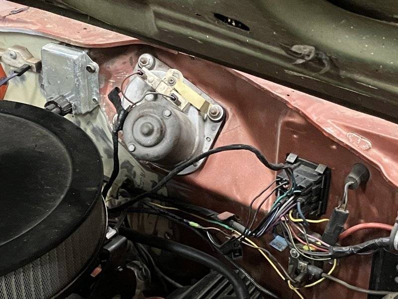

I thought I read somewhere that the under dash wiring is the same. Since I have a 3 speed switch in the dash but only have 2 speed motors that are complete, I bolted in a motor.
I gave it a try without the motor connected to the linkage. Nothing.

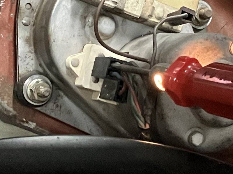

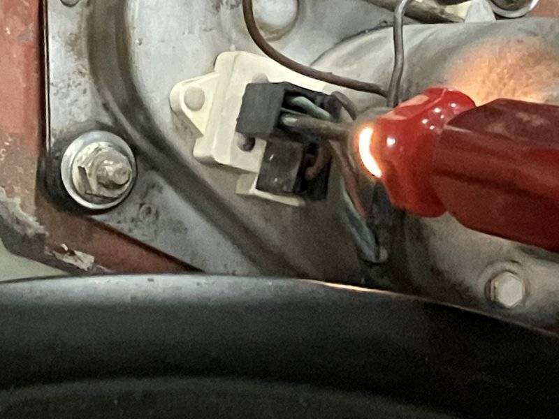

I’m getting no power to the ballast resistor but am getting power here:
No power to the wires behind it. I have the switch on low.

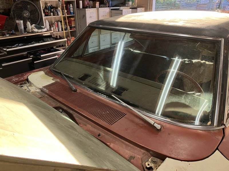

In keeping with my habit of jumping in and trying to learn as I go, I hodge-podged my wipers to work.
They only have one speed and they do not park.
Pfft.
I just need to pass an inspection. They only require one wiper anyway.
The RH wiper is an oddball a little longer than correct but it fits and works. The motor is a two speed, the switch in the dash is a three speed. I read that the two speed linkage has some other piece to make it “park”. I’ll have to pull the red car out to look closer. This is the best picture I could muster of the back side of “Ginger” two speed wiper.
I can’t quite see how it differs from Jigsaw.

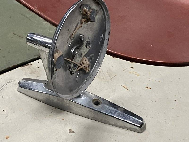

The left outside door mirror was missing the glass.
I found one in the shed with the exact same base. The head is different but it has a mirror you can see and it will meet the standard.

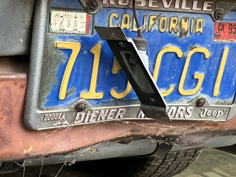

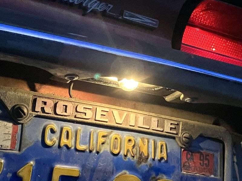

The license plate light was missing a bulb.
The socket needed a little soaking of WD-40. I pulled a bulb from my stash…
It needs a lens to cover the bulb. I could make one out of 3/16” plastic sheeting from the store or find a factory one.

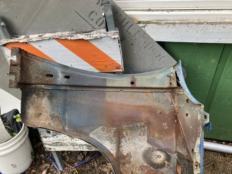

I have another fender that I could use but it is damaged in another area:
The edge where it meets the door is caved in.
The rest of the fender is in better shape than this white one. The bracing is bent but I do have this…

I’m unsure which option is best… straighten out the white fender or fix the black one.
This white fender was in a swap space at the Spring Fling show at least 12-15 years ago. I paid $20 for it! With the insane explosion of popularity of these cars, I’d surely have to pay more than double that for this fender today.
