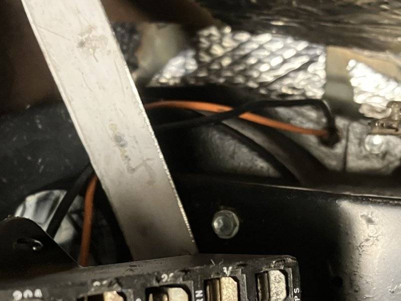

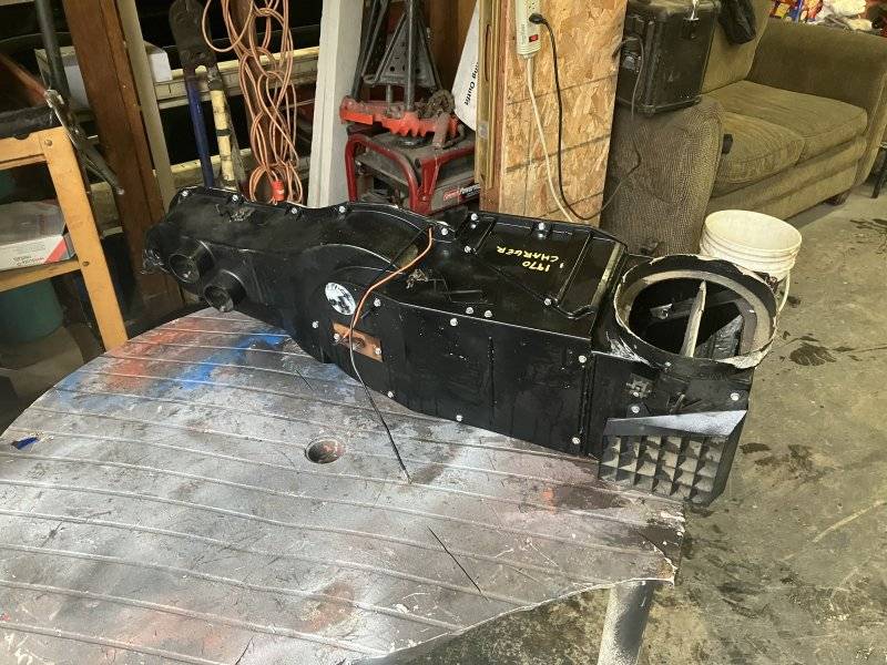

The control panel has wiring with a plug that attaches to the heater blower motor resistor.
But… the blower motor has two wires coming off of it. Black and orange.
So far, I can’t find anything in the FSM about where they attach.
One cable control the blend door to control the temperature by either forcing air through the heater core or allowing air to bypass...
Other cable directs air to the defrost or floor...
Should be a couple cables mounted under the dash to control fresh air both from the heater box cowl door & from a vent on the drivers side...

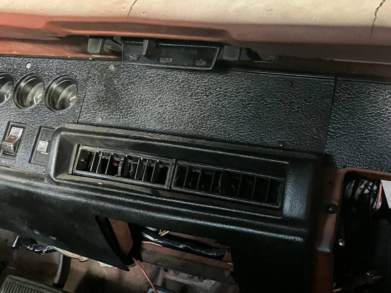

I guess I need a NON A/C drivers side cowl vent box. This car had A/C.
I decided to add the simpler heater/defroster just to have heat while I slowly build and drive the car. I spent 18-19 years in the red car with no functioning heater at all.
Also, the Non A/C firewall stamping is much more tidy. If/When I convert to Classic Auto Air, there will be no big holes to block off.
Finally....the electrical switch on the right side of the panel...how stiff is too stiff for the movement of this? Are new switches available?
When the switch is stiff it's probably been overheated because there is no relay and all the current passes through the switch... I'm not aware to a replacement switch but to be honest I haven't looked lately...
My reproduction Factory Service Manual isn’t real clear on the cable orientation so I took a guess on it. The control panel I got has a slider button on each side of the “Off Heat Def” center.
I did see that the RH fresh air vent is supposed to have a long cable that mounts to a retainer and pull knob near the steering column.
The LH vent is independent of the system in this car as well as the red one. Maybe they used the same LH vent for all models?
The cables in this panel are stiff. The doors on the heater are too. As a result, one cable kinked up near the panel. I didn’t expect much from this unit since I got a good deal on it. The blower switch goes off when I try to put it on HIGH speed. I get low and slightly “more than low” speeds.
I don’t know if it is worth spending money on new cables since it won’t be in the car when I add A/C.

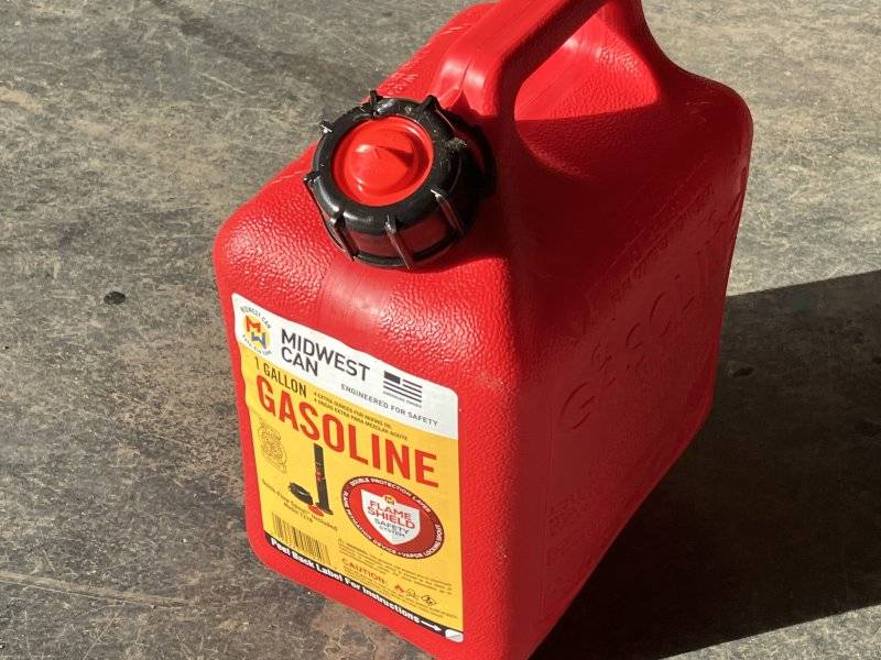

The station had these stupid gas cans:
Economically priced too…$18!

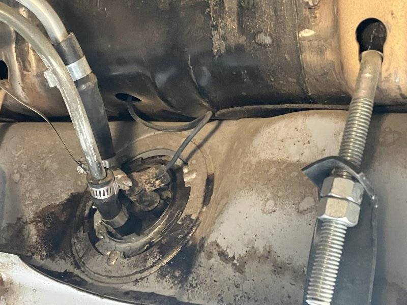

The gas tank was leaking. Gas station patrons and employees frown upon flammable liquids being dumped on the concrete so I drove out and onto a side road to get a look.
Of course, it can be hard to see with gas dripping in your face.
It turned out to be that return/vent line, the one with the worm clamps. It had slid off, allowing anything above it to gravity “bleed” out. I stuffed it back on. While I was stopped, I reached under the dash and pushed the speedo cable in better. The end locking tab is broken so I don’t expect it to stay.

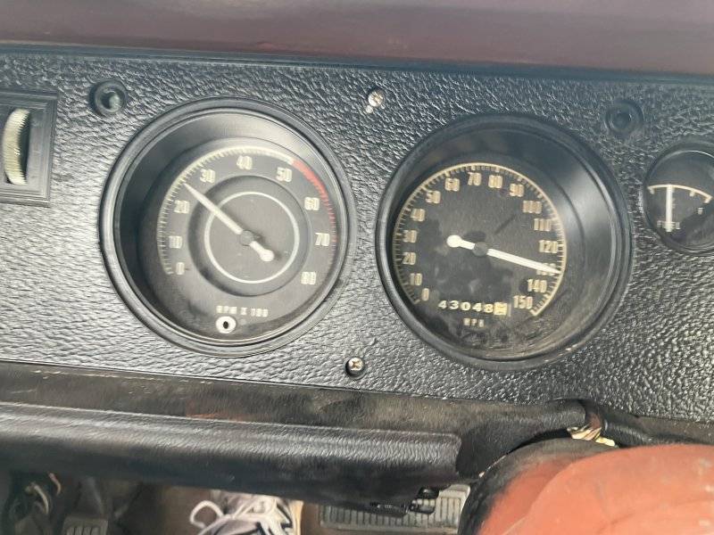

Out on the road… the car hauls ***!
Actually…

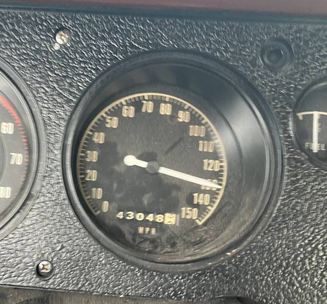

130 mph at 2500? With 3.91 gears??
The speedo worked fine at first but when I looked down again, it was at hyperspeed.

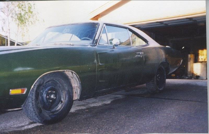

When Ginger was still green:
In similar condition... 440, 727, 8 3/4" axle, original A/C, bucket seats and console but no frame connectors or torque boxes: 3750.
