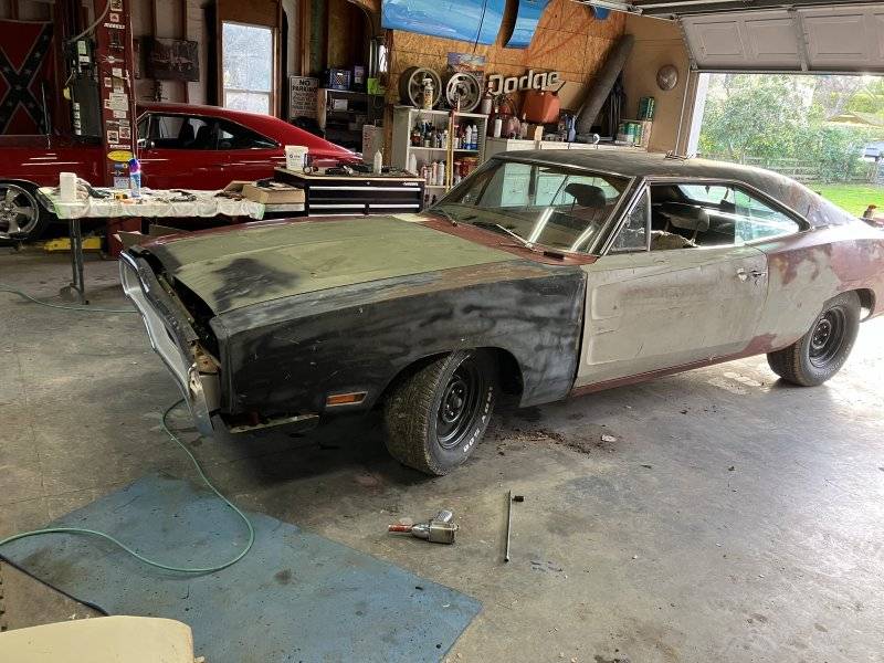

Lookie what $5000 buys you....

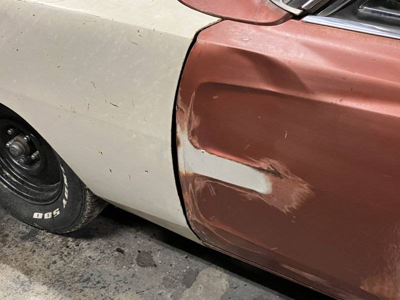

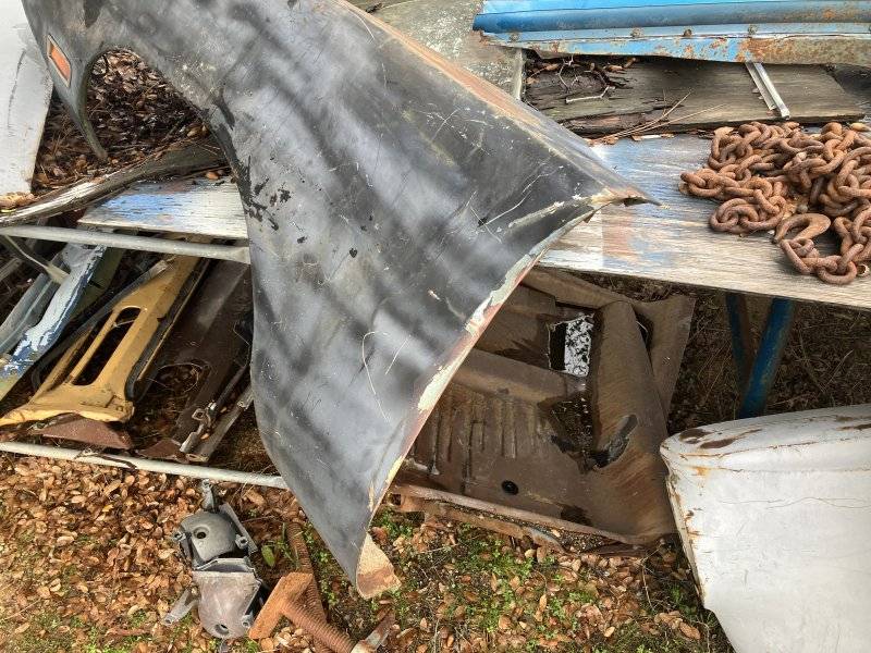

The other day I was looking at the fender that I swapped in awhile back.
Given that there are no steel reproduction fenders made for this car, I'm stuck with buying something used or making do with what I have. The black fender isn't perfect but the white one I had on there was worse.

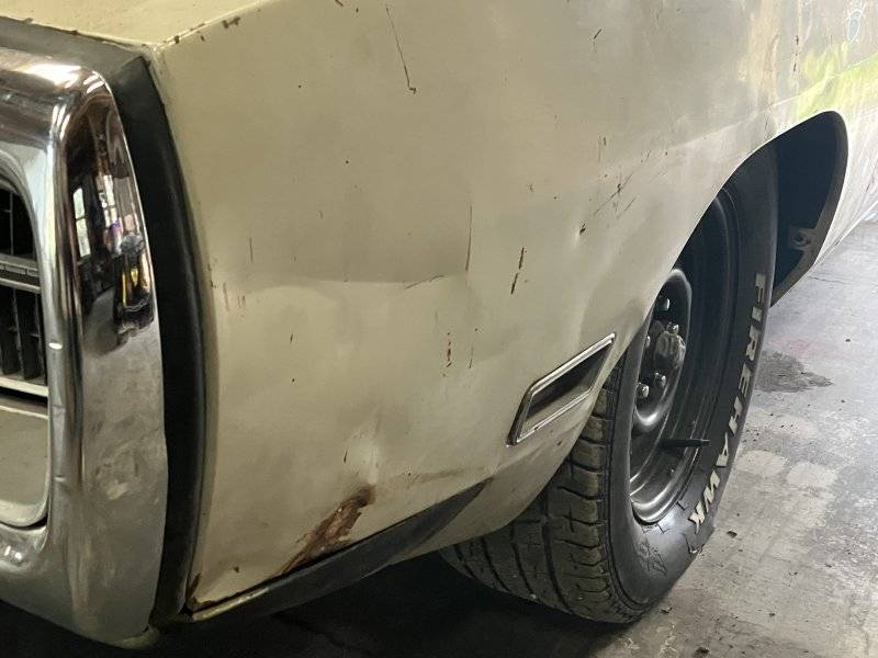

I bought the white one 20 years ago at a swap meet for under $100 ! Have you seen what some guys are asking for these now?

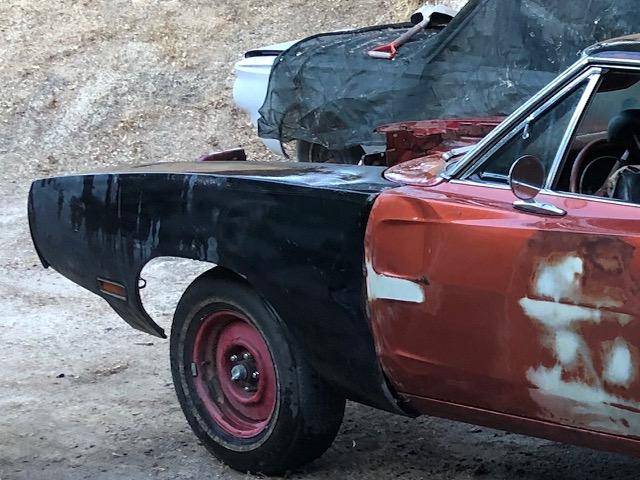

This black fender came in the deal with the car back in September 2019.
It is pretty straight except at the door edge.
It looks like the car was in a front end collision and the fender was pushed back enough to obstruct the door, then the driver shoved the door open, bending the edges of both the fender and door.

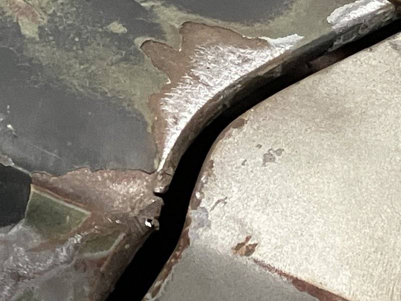

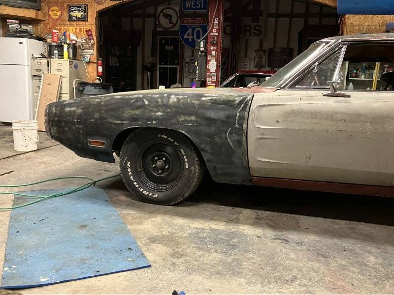

The door edge of the white fender was the cleanest part of it. The rest of the fender is repairable but would take more work. I chose to use the black fender. I straightened out most of the creased edge and bolted it in place.
The door was pulled and replaced since I wanted to have one of the two panels with a clean edge to work with.
The door edge will allow a point from which to work. The fender damage did result in uneven gaps that will need attention. I've done this before:

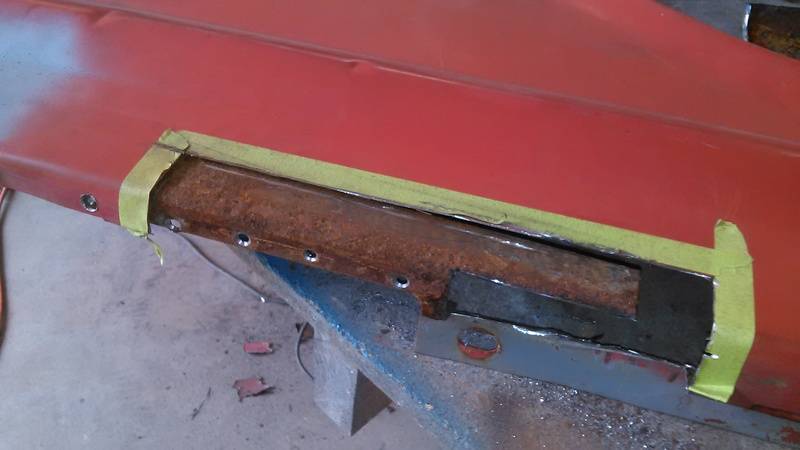

The fender still has that wrinkle in it that would be hard to get out. I can't hammer and dolly it since that brace is behind it.
My original plan was to pull out the brace, straighten the edge of the fender and replace the brace. It turns out the brace is unique to the Charger but probably fits from 1968-70. It means caniballizing another fender which isn't cost effective. I'd almost be limited to scrounging for an otherwise junk fender just to harvest the bracing from it.
Nah...
I could remove the brace, hammer and dolly the waves and weld the brace back in....OR try pulling the low spots up with a dent puller using those welded studs the pros use.
I'm just spitballing here....It is raining heavy and I'm not in the mood to go out to the shop!
I'd use the dent puller with studs, Harbor Freight makes it accessible and there may be even cheaper ones that work on Amazon.
Looking at the issues with the door and fender, I'm thinking if you were able to do some sheetmetal pulls on the two edges, they and some of the other problems would get remedied. For the pulls, both units need to stay bolted on. You weld pull tabs, not nails, to the edges to pull against. As you're tugging, work the area there and further back with the hammer and dolly routine. You could quite possibly use a come along for the pulling with something clamped or welded to the pull tab edge for the CA to fit into. Slow, steady pressure works many wonders as opposed to hard yanking. You'll need to be careful as on both of those edges, you're dealing with an inner structure and an outer skin. One may seperate from the other as you tug. Both the inner structure and the outer skin are playing a part in the game. The inner structure probably more so as they are generally thicker material and the contours/shapes of them make them very strong. The damage to those edges/inner structures will be a major player to the damage further in. All locked together. Some examples of tools to use or get ideas from.

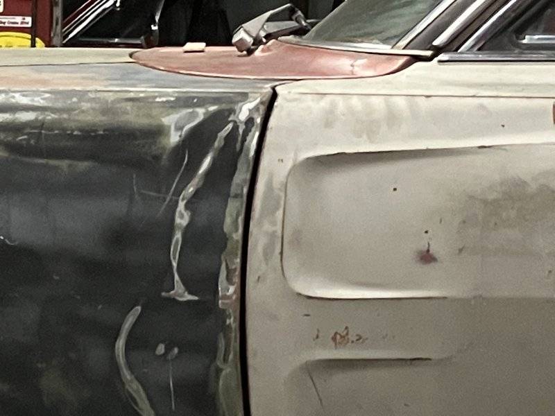

The flange of the brace is pushed in at the side nearest the edge. It probably isn't visible in pictures but enough to leave wrinkles in the outer skin and a gap that is inconsistent.

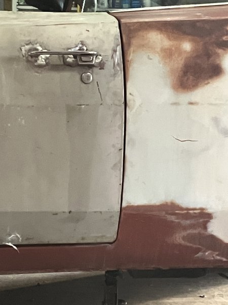

I was able to get the flange even with the door in terms of in/out but the gap sucks. The other gaps are not too bad.
I already need to address the area near the point below.
The gap isn't bad in this picture.

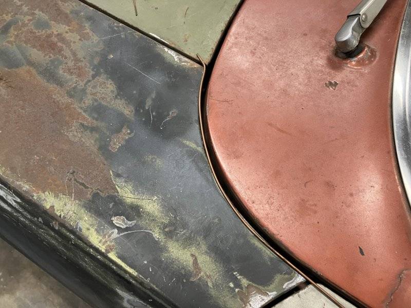

It seems too tight at the rear of the door to quarter area:

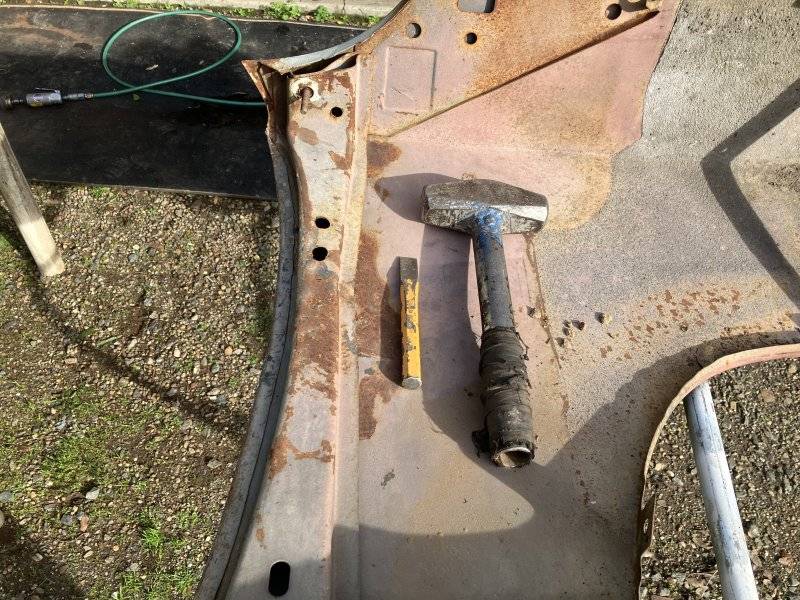

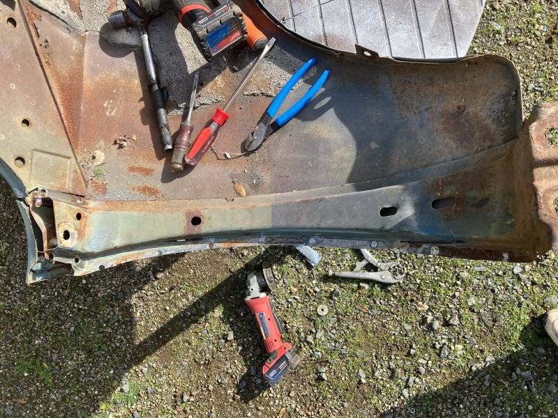

The replacement rails were cleared of all the old floor pan and welds, then I went to work removing the rest of the RH frame rail. The center pin in the spotweld cutter broke so I called it a day. I noticed that the floor pan is buckled a bit on the right side. I expected there to be some additional work to get this replacement stuff to fit.
The torsion bar crossmember looks fine though. That is encouraging!
