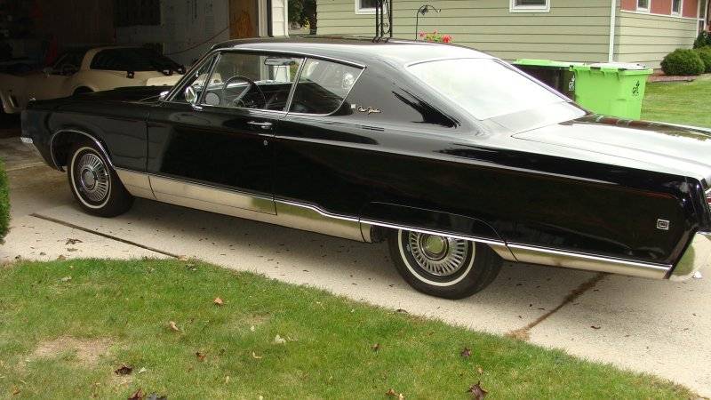

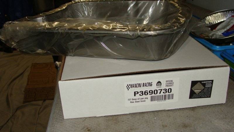

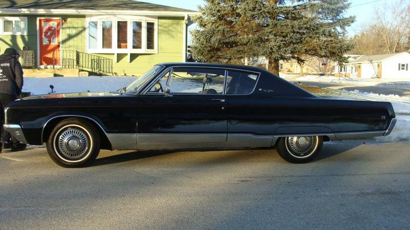

I guess I'll hijack this thread for a brief question.I recently put this pan kit on my bone stock 68 NewYorker, came with filter extension, anyone near my location for a drive-in trans rebuild in the future? A stock rebuild w/minor upgrade would be my goal.
