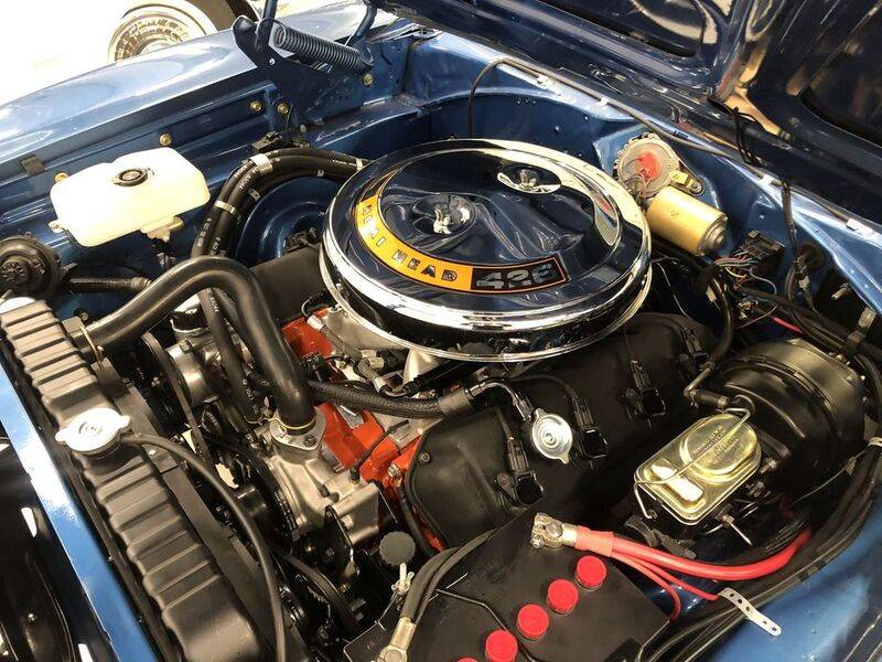

I am looking for pros cons about going EFI on a gen II 426 HEMI. I have a 66 that is in my 69 Roadrunner and have wondered the benefits of going EFI.
I would like to hear about what system you have and how it compares to running carbs.

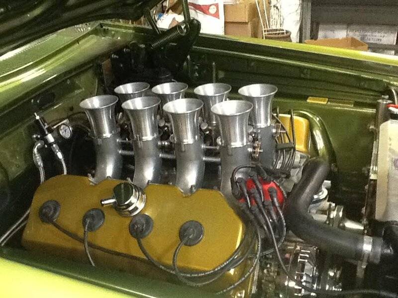

My buddy @ Fox Injection in NC was able to find an 'Enderle' vintage 8-stack setup for me a couple years ago. I'm using 'short' stacks, plus an EFI conversion. Short stacks stay under the scoop, too. Got another hood for the long stacks. BEST investment ever for my '65 Coronet AWB. Has the 'wow' factor that carbs will never offer & I will NEVER look back! Yahoo!!!!!
OH, ALSO the car 'starts' with just a flip of the key.....no pumping the gas pedal, no setting the choke, no nothing, turn the key & VROOOOOM!!!

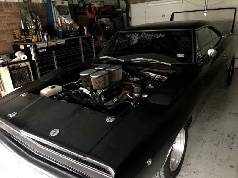

I have always been a multiple carb guy. One 340 sixpack, one 440 sixpack, twin 1050 Dominators on Hemi, cross ram Hemi, cross ram 413. However, I may switch my dual Dominator set up over to EFI eventually.

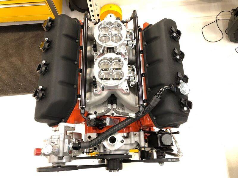

TBI is an electronic carburetor.

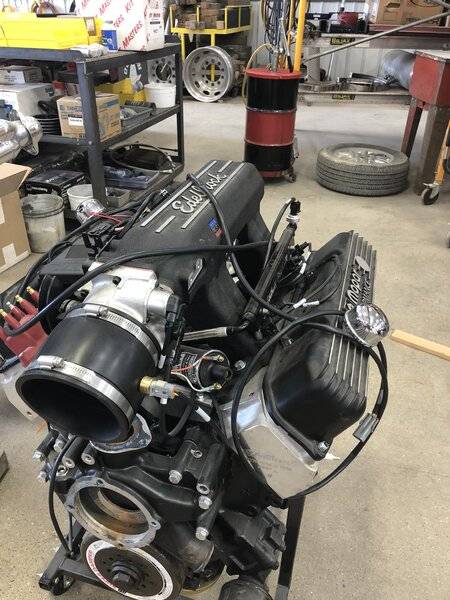

Pro Flo 4. Easy: Firewall forward. Misery: Fuel delivery. Zero tuning issues.
Now that (i think) it’s sorted out, the back panel isn’t black from soot and oil doesn’t smell like gas. Oil stays cleaner and consumption down from a qt per thousand to none detected. Hot restarts now possible.
