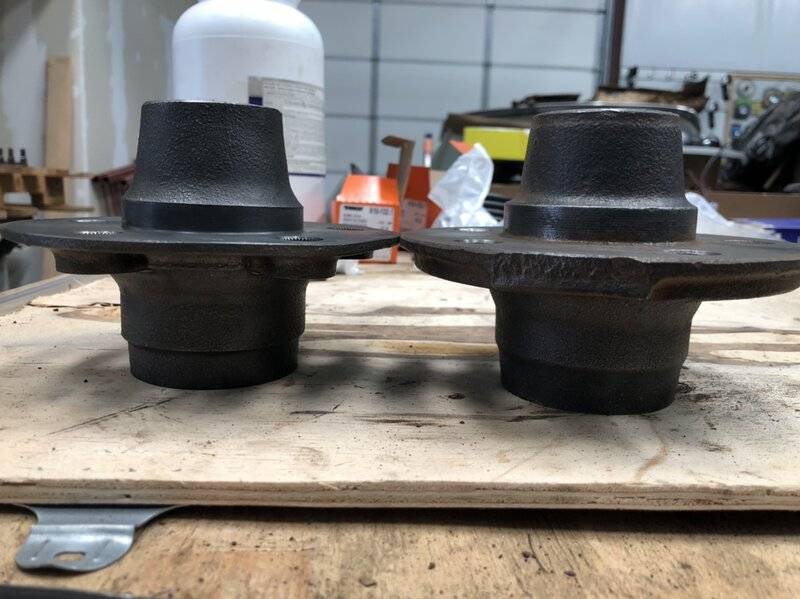

Hub on the right looks stronger.

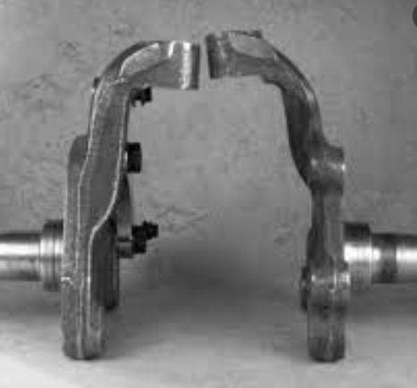

spindle on the left looks stronger.

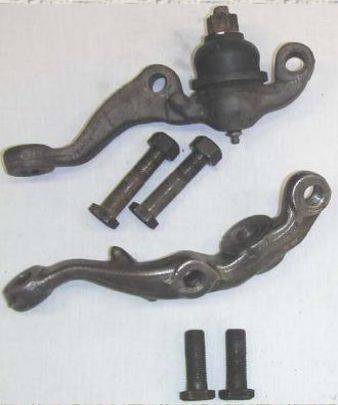

Lower arm would match my lower ball joint in A arm setup.

Left side spindle looks forged hard to see great. Cast spindle on right id walk away from. Bearing hubs need more info as to sizing.

I think a forged spindle is all I would use. The one looks beefier and forged and the extra weight would not be a consideration. I just don't know what to go looking for in the wreacking yard.

Need to take side by side pics of the spindles both facing the same direction. Can't remember their user name anymore but there's a member here that knows about all the differences through the years. Looks like the spindle on the left has a bracket bolted to it? And both of them look forged to me. Might take a file to both and see if they act the same or not.....

The lower steering arm in the picture might be easy to adapt to the Ford lower ball joint or if not, a ball joint-in-steering arm could have it's ball removed and a bung with the right tapered hole welded in. There are different hole spacing on different steering arms, maybe I can end up with a bolt on fit.

Those hubs you posted look like front drum brake hubs wit the studs and drums removed. Most of the brake rotors are a one piece unit on mopars.
