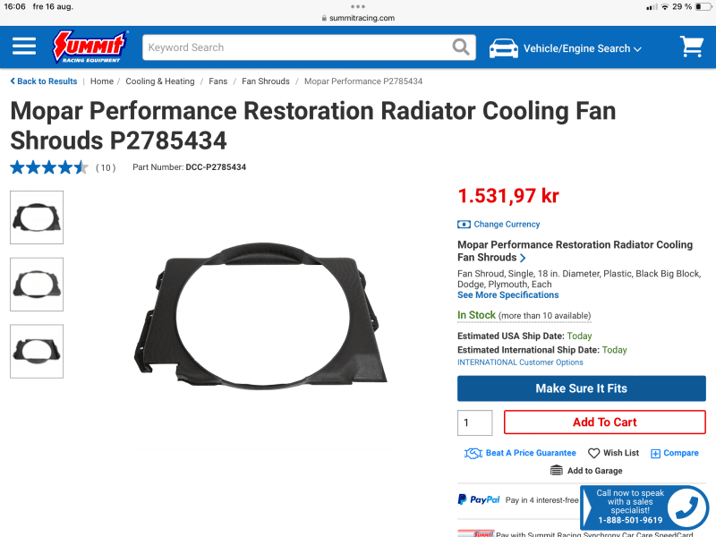

Hi !
Need a shroud, never had one in my charger 440 and its always a little hot when ideling
Found one that I can get my hand on in Sweden, want to know if it fits.
Radiator is 26 in.
Fan is 18 in.
On my radiator there is 6 studs for fanshroud mounting, the shroud i find is a 5 stud mount. Does it matter?
I cant find anything more corecct.
See Photos please
Looks like you're in the same boat as me. I bought the shroud shown in your picture then bought a 26" replacement radiator that was for a b body. Shroud didn't fit like you are finding out. I cut the studs off and made some mount flanges for the shroud to work as I was in a bind. I did drill and tap out the remainder of the studs for when I found the correct shroud to fit that radiator. Turns out that radiator also fits 66-70 c body. By the pictures of a shroud for the c body, its a match.
Mancini Racing Radiator Fan Shroud
[QUOTE="ckessel, post: 912914555, member: 21001"
Thanks! This helped alot!
The one in your link seems to be a perfekt fit. Thank you!
You have a 1967 C body radiator with 6 studs. So the shroud you have shown does not fit, it is a b-body shroud, 5 studs.
I need to get that plus the proper pullies for the water pump and crank.
Tanks for making things clear!
Any idea of how a 67 c body radiator WITH shroud Will fit in my B-body with 440?
Will the fan line up in the shroud ?
Iam guessing if evertying is centered it would fit?
