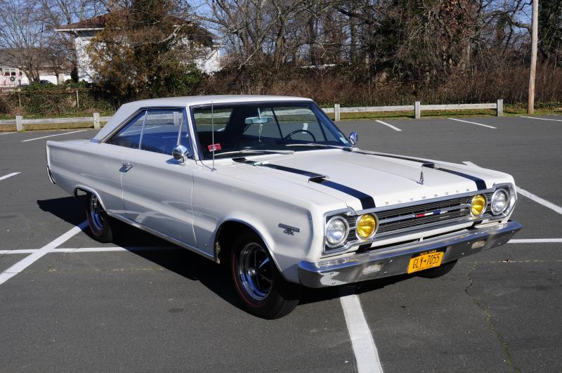

Hi fellow b body guys , im looking to convert my 67 gtx over to power steering . Any help would be great. Is there a lot of drama involved?. Figured it would be a good time to do it while i have the motor out. Thanks _DSC0458.jpg
