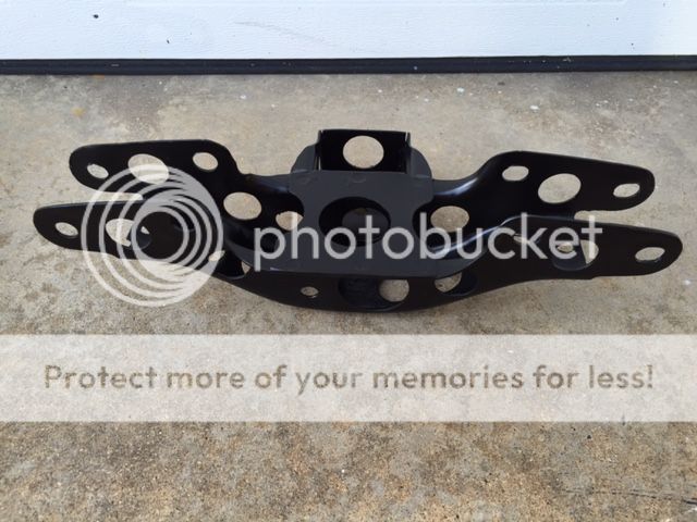

1) correct way to lighten k-member

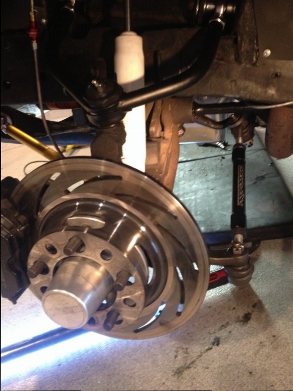

AlterKation front suspension took 150 LBS off the front end of my car !
Cut the K-frame, 18lbs. Cut the inner door panels, remove regulators, install 1/8" Lexan except windshield, 86lbs. Tube steering shaft, 7lbs. Carbon fiber bumper brackets, 23.5 lbs. Tubing strut rods, 5lbs, aluminum hood pins. Aluminum drive shaft. Internal trans weight 15lbs. My 64 weighs 3120 w/o fuel or driver. It is all steel except hood. Steel bumpers, old school American wheels, fire system, 2 45lb batteries. Megablock, large cast intake with 2 carbs, Dana, dual factory fans. Lots of extra cage tubing. Just missing lots of little stuff.

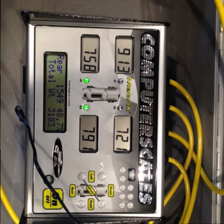

This is all steel[except hood] and all factory window glass. Hemi, dana, legal S/S cage, etc...... 3185# in the picture.

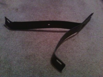

I got a bud with a plasma cutter to cut holes in my front bumper brackets. Going with glass bumper but wanted to leave some strength in the brackets.
Mike, mine is down to 3183 with me in it. 2980 without me. Running two batteries. no alternator. Always looking to get lighter. The entire front end inc doors and bumper are glass. Lift off hood, I did make some aluminum interior fender wells not hang the air in the engine compartment. Also built a front end pan to push the air smoother past the engine compartment to the ground.
Still working on that though. I would not be interested in chopping up parts to lighten. Getting the weight adjusted is very critical. Changes in weight chage the balancing of the car.

These readings show a need to add load to the right rear by at least 90lbs if the driver is in the car.
Doug
Doug
Correct this was just a pic out of my car window not the final adjustment. Prior the car adjustments launch would hook right. Now you don't need to even hold the steering wheel on launch. I will see if I have the final picture. I was just showing the weight of the car.
