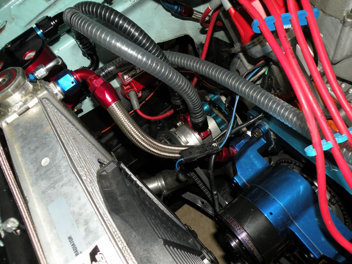

if your running a vacuum pump then low tensile rings are a huge plus. otherwise standard rings are fine.
No vacuum pump for me. I've thought about them but being what it is, low 10's, I'm thinking it would probably be more overkill. Thank you.
