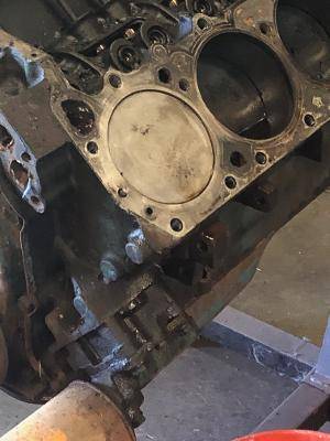

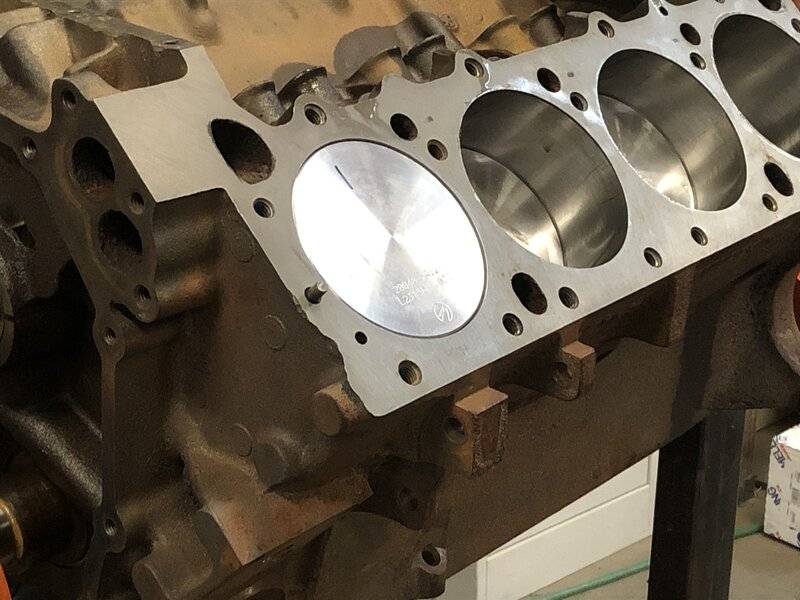

I have this same cam in my 383 in "Jigsaw". I did put new pistons in it to bring the compression ratio up to a respectable area.
Stock replacement pistons for my 383 would have put me at a calculated 7.85 to 1 ratio. Yeah, I checked my numbers several times and yes, those are correct. Most gasket sets come with the .039 compressed thickness head gasket while the stock engines used a .020 steel gasket. The pistons in mine were .076 in the hole, the heads had a 92 cc chamber.
The new pistons sit .015 in the hole, the heads have 83-84 cc chambers and my compression is at 9.2 to 1`. I have 1 7/8" headers and my car weighs less than yours. With the 3.23 gears, the car was pretty slow. With 3.91 gears, it felt much better.

@Kern Dog: Thanks for the info. So it sounds like compression isn't enough to make what I have work. Maybe this cam isn't good in the low deck motors.
I see it as a matter of your compression being way too low for the camshaft. A smaller cam or a switch to much smaller chambered heads would help.
A switch to the 75 cc aluminum heads would make a 1.5 point increase in your compression ratio. If you're at 7.8 with the combination now, you'd be at approx 9.3 with the smaller chambers.
@Kern Dog: Do you think 9.2 with aluminum heads would be a little low? I think I am convinced (thanks to the fine knowledgeable fellas on this thread) to pull the engine and do a stroker. Do you agree that that's the best way to meet my goals?
