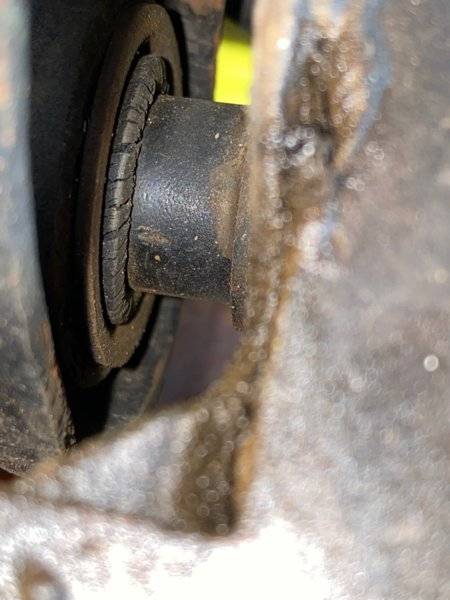

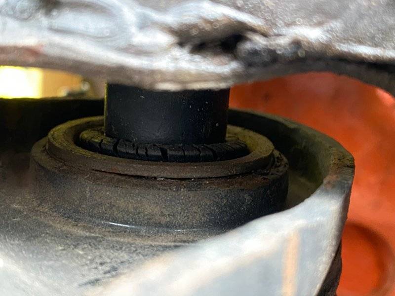

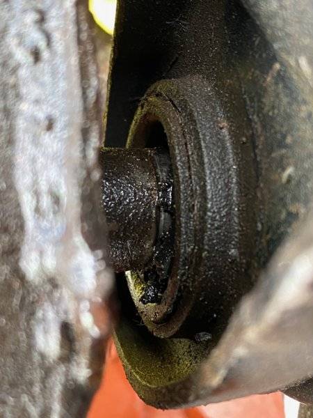

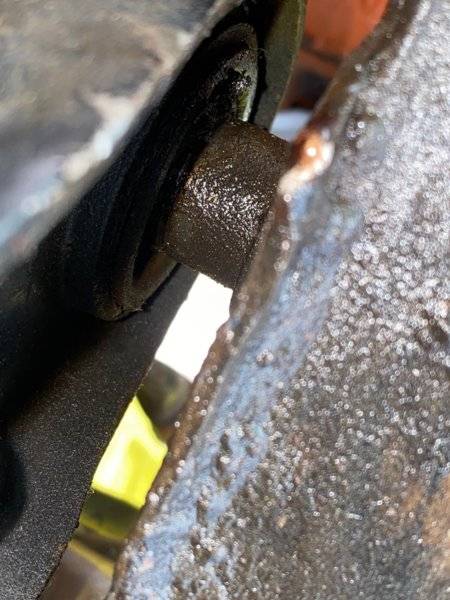

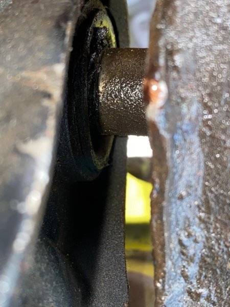

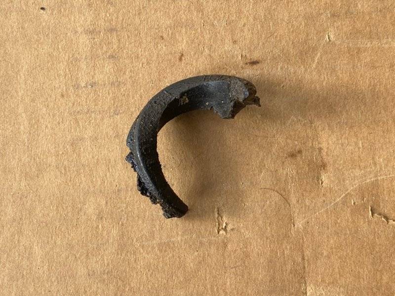

In the process of a Power Steering system replacement, I've encountered some issues with my lower control arm bushings. The rubber part of the bushing is partially torn out of the driver side, and has cracks on the passenger side. Looks like the driver side needs to be replaced, and maybe the passenger side too. What do you guys think, is this something that can wait a bit longer, or should I do it now?
The driver side bushing is wet with ATF from a leaking steering gearbox that is now out of the car. The continuous exposure to ATF, from the gearbox, may have contributed to the rubber tearing out at the end of the bushing.
LCBDriver3.jpg LCBDriver4.jpg LCBDriver6.jpg IMG_1475.jpg LCBPass1.jpg LCBPass3.jpg
It definitely contributed. But they don't look too old, judging by the anodizing I see on the sleeve. How old are they? There's been quality control issues with the once-popular Moog brand. Proforged seems the way to go.
Based on the pics, I would say they still have some life left but keep an eye on them. If you notice the pivot shaft moving away from the center....it's for sure time to jump in.
3 say I could hold off, 1 says time to replace.

Get it on the road and see how it tracks, and responds. If there are no issues (loose feel, straying, play, wandering, pulling) then enjoy it until something develops. That could be years.
