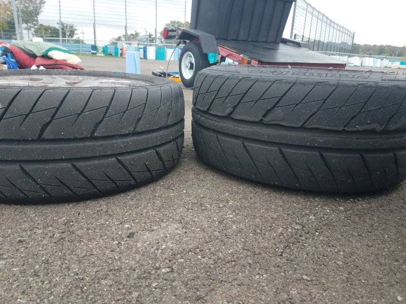

Yep...for reference 15x6 and a 15x9 with a 225/45/15 looks like this
Those are two different size tires

They were not. Both were the 225/45/15 rs4 Hankook. Its amazing what rim width can do. Why we are wanting to at least run a 9 inch wheel but would prefer a 10 or more to get some more with advantage. Shoot in Maita land a 205 was fastest on an 15x8 inch wheel and a 225 was fastest on the 15x9 inch. Some of the fast guys started running the 245 option on some 15x10. My daily driver c5 has a 275 on a 10.5 and its just starting to stretch. The rear is almost pinched with a 295 on the same 10.5.

Really?
Because the top side above the large center grooves looks exactly the same width, but the bottom width visually looks much different.
Explain how any rim can "stretch" only one side of a tire.
The center rib/grooves also do not appear the same size.
Really?
So on those the tire on the left was mine. It was on a stock 15x6 inch wheel. if you look at it its very pinched in. Really the 225 is not recommended on a 6 inch wheel. But my tire was sitting on the tire. Buddies 15x9 is on the right. As you can see in the side wall its stretched. His was sitting on the rim as the rubber was not touching the ground. If you look at mine some of the tread is rolled over to the inside.
Your explanation above does not match what my eyes see. Again, and mainly, why would only one side, the lower side on the narrow rim, "roll under" and plainly in my eyes, be narrower?
The only explanation here might be, camera distortion, but that would have other telltale signs, that I do not see.
And again, the tire does not stretch, its inherent dimensions stay relatively the same, the tire changes shape from being inflated, balloons stretch and change dimensions.
If you truly believe a tire "stretches", then so does a scuba air tank when inflated.
