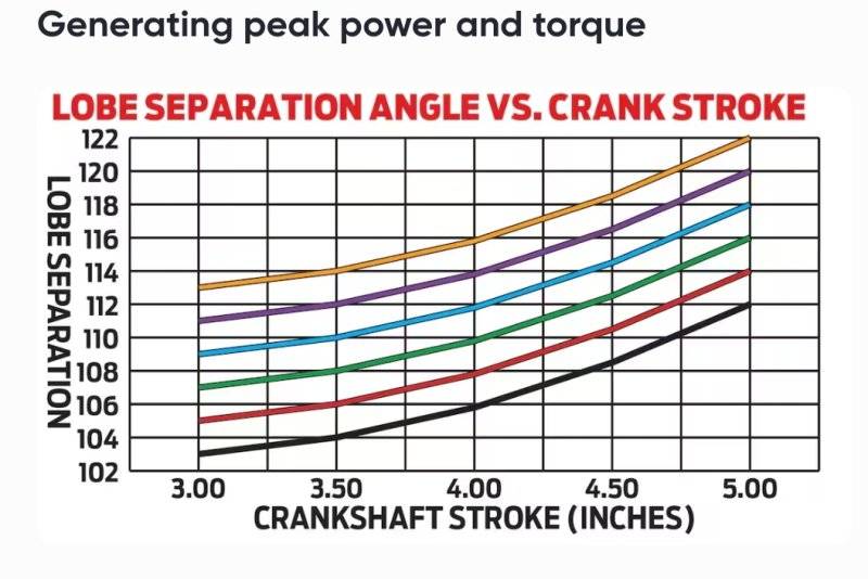

Also with a wider LSA you can run more duration and have the same overlap. Stroker engines can sometimes fit the build better as a wider LSA moves the power higher, plus more duration is needed to feed the larger dispacements. More duration then feeds air and fuel to the bigger engine and more lift makes power if the heads will support it. There is also a relationship between crankshaft stoke and LSA. But, this is a relationship to the power band...not horsepower.

As duration goes up as stated a wider lobe separation is required to keep overlap in check. But that is just a function of getting the important stuff right in the first place. The real trick is choosing the correct intake closing point, the correct exhaust opening point, and the correct duration for the application. These will determine the overlap/lca.

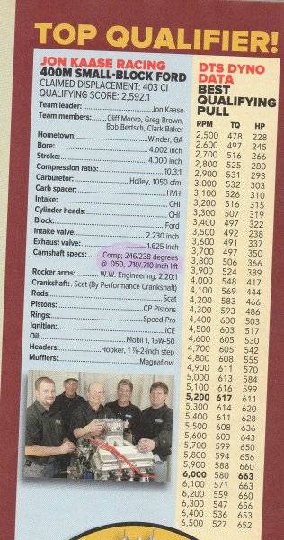

Jon Kaase won the EMC with a 400 Ford engine that made 660 hp, wide tq curve, with a tight 98 LSA flat tappet cam.

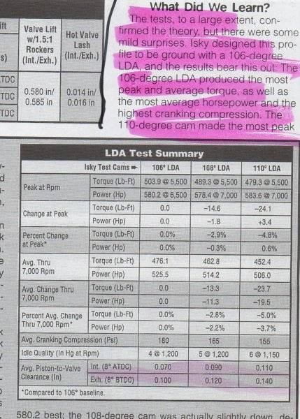

Isky Test of 106, 108, 110 LSA cams. Notice the 106 lost 3 hp at peak rpm.....but was up nearly 24 ft/lbs in the mid range.
I hadn’t seen the Isky one. But John K was my customer at Scat. I was their senior engine tech. Worked with drag,nascar,road race and factories. I really learned a lot working with these teams and guys from the factories. I had lots of guys we helped on the Engine Masters challenge. John used a short rod on this 400m setup because it had a huge port and valve for the cu.in. The short rod accelerates the piston away from the head faster which make the working air mass less inclined to be lazy. He has a 2.2 intake. We have a 2.14 feeding 40 more cubes. Would he use this setup in a race car. I highly doubt it. I’ll bet Doug’s car flashes 5000 and never goes below 5k till the stripe. So they don’t need a flat torque curve down to 2500. But a setup Streeter with a 3k converter or a stick, and 3.55 gears I believe would a place to experiment. I think I’ll drag out the porting tools, start saving for the rotating assembly and look for a local Dyno to do before and afters. Till then I’m enjoying the info I’m picking up on this site.
