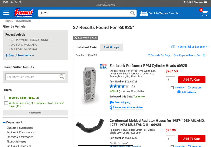

That’s a pretty go observation with the valve covers on. If you notice the price of the assembled heads you will notice that it’s a lot higher than the going price for 60925 heads. They got a packaged deal that included Proform 440-873 with new mounting bolts and push rods. That’s why the push rods have no price listed. They just included everything in the listed head price on the work order. Just lazy I’m guessing.

The head price seemed about right to me($1935 currently), so I made the assumption.
