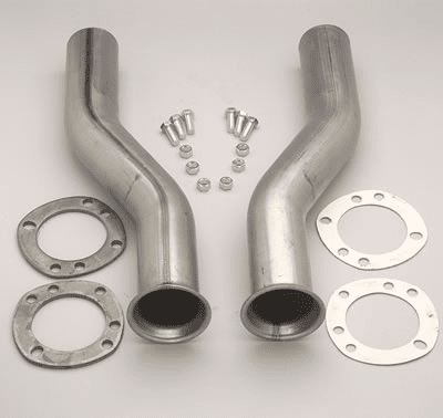

headman makes an offset pipe kit . i use to use them just for this issue . summit racing carries them . search headman S bend exhaust pipes
