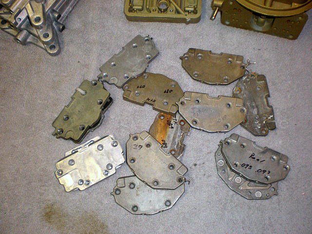

Q/F has a cast plate,1/2 the price of the billet ( picture attached) and there are no fitment issues or float interference but you have to get it directly from Q/F.As for Promax,never could figure out why they are priced as high as they are. I have quite a few plates if you choose to go with original.You say you are running rich,at speed or at idle and also what jets in center carb?

Q/F has a cast plate,1/2 the price of the billet ( picture attached) and there are no fitment issues or float interference but you have to get it directly from Q/F.As for Promax,never could figure out why they are priced as high as they are. I have quite a few plates if you choose to go with original.You say you are running rich,at speed or at idle and also what jets in center carb?View attachment 314838View attachment 314839

I've got a '70 4spd six pack setup with front carb #4382. It's been running "pig rich" and the carbs have been modified, so I'm trying to put them back to stock and work from there.
This particular carb (#4382) calls for a 34R-6153-34 metering plate. I can't seem to find this metering plate (at least Chicago Carburetor & Six Pack Performance don't have any). Right now, I have a 34R-6153-35 metering plate in BOTH my front & rear carb since that's all I can find. Art at Six Pack Perf. was kind enough to tell me the orifice holes on the -34 plate are .089" pass. & 0.093" driver's side. I'm trying to avoid the expense of the ProMax metering plates with regular Holley jets in them.
Does anyone know how I can make my own -34 plate? Is there a similar secondary metering plate out there (same configuration with smaller holes) that I can just drill out to .089"/.093"? What about the -35 metering plates?
Thanks for Your Help!
YES.....you are correct...the Promax metering plates are a little $$$, but IMO, are totally worth it. As you are considering (?) making your own, how were you going to do the various passageways...including the emulsion channel's ? The idle fuel restrictions are pretty much constant or made slightly rich (0.002" - 0.003") to fix a lean idle mixture or remove the sealing plugs on the "hidden mixture screws". Over the years of buying Holley metering plates at swap meets, looking for a solution to uneven mixture distribution, I bought the Promax plates, to use the standard Holley jets, and experimented and wound up with the ability to stagger jet the carbs to get better fuel distribution and more even spark plug coloration. Just a thought......
